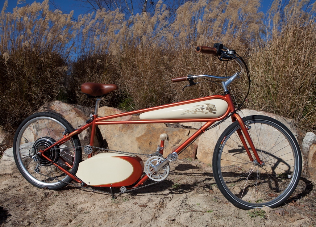

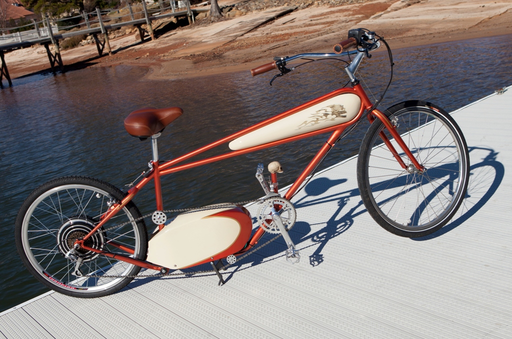

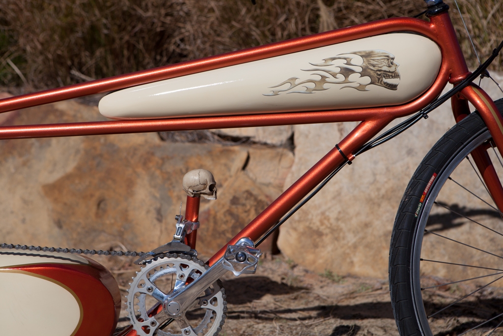

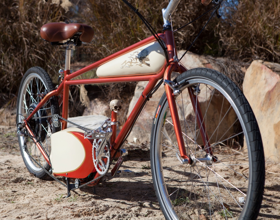

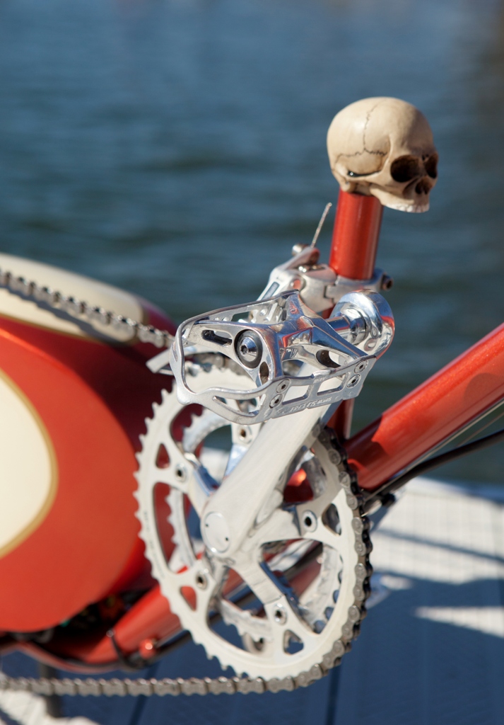

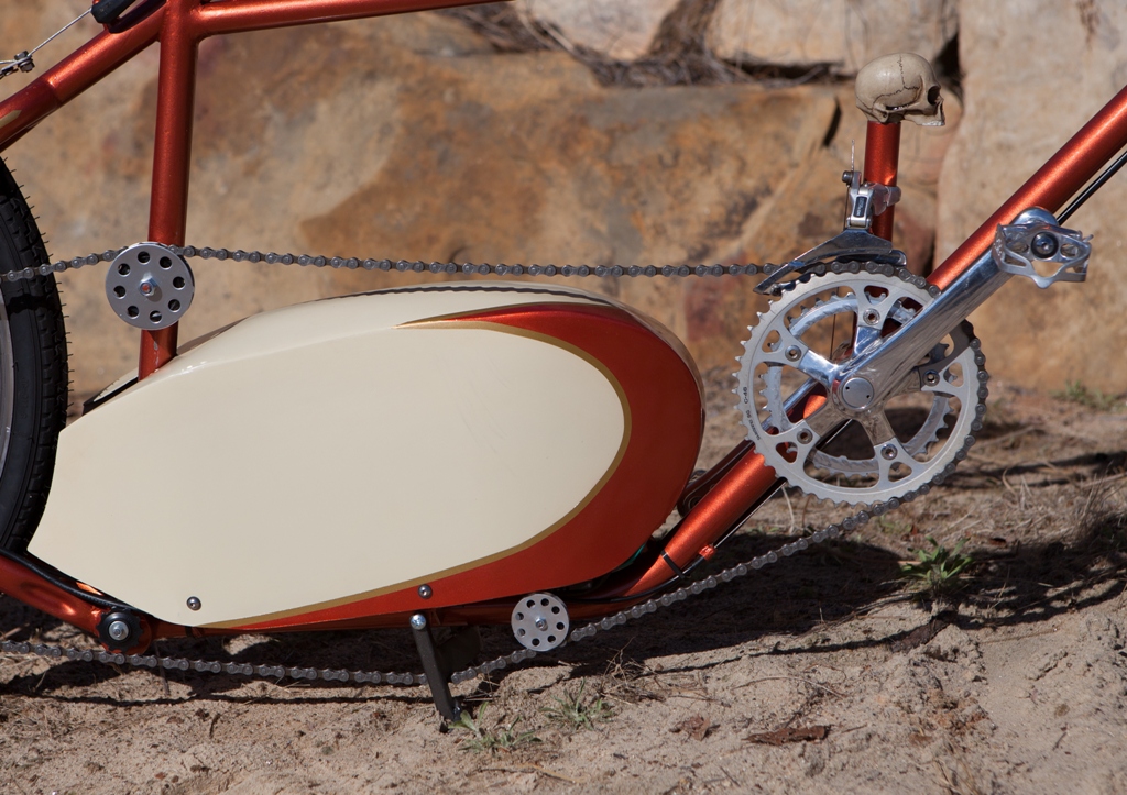

Since I have some extra time on my hands, I present you with the "11th thing to do while waiting for my SLC kit to arrive"...Build something else!
I built this electric bike in the Bobber style. It features a custom fabricated frame, custom metal tanks and paint with a skull motif. It's powered by a 1000W electric hub motor and a 48V lithium battery pack. It cruises at 30MPH and has a 35 mile range. It ain't fast, but it's a cool grocery getter!

Bill this is cool, if this is any indication of your fab skills I can't wait to see your finished SL-C, its going to be nice. Did you air brush the skulls on the tank.

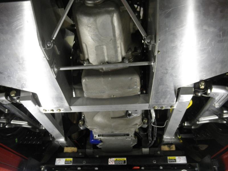

I'm installing the LS to G50 Adapter plate from RCR. I noticed that the plate does not connect to the lower bolts. Is this correct?
See red box below
Yup, on the ricardo those didnt orient either. I think the alignemnt pind do most of the hard work here. As long as the tranny pulls snug on those, that hardened steel pin is pretty stout. does that fit snug?
Cam,
Thanks for the PIC...It makes me feel better.
Yup, that's the oil pan. However, the oil pan on a LS motor is a cast aluminum part that is designed to be a stress member.
I didn't get any alignment pins with my transaxle? That would have made mating it a bit easier, haha!
Alex,
You have to buy them separately. Not sure it makes it any easier to mate tranny to engine though....seems they are virtually zero clearance.
