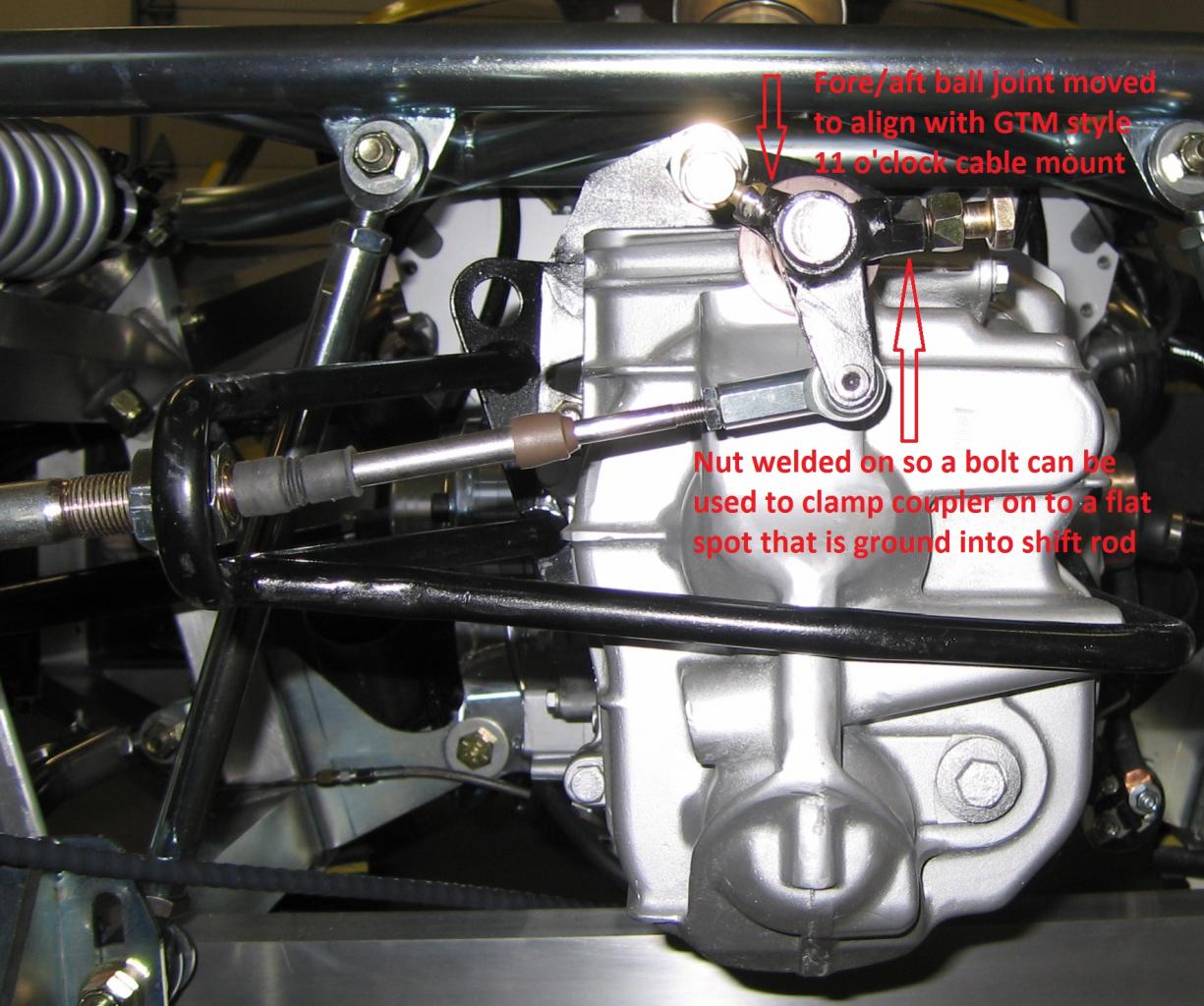

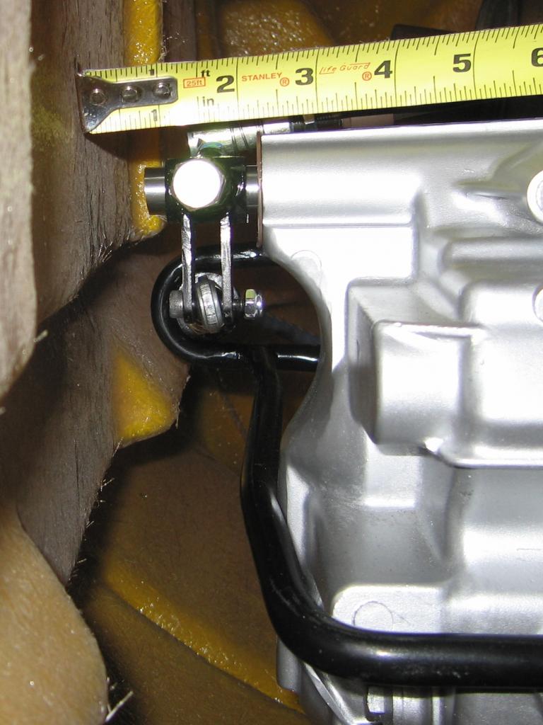

I further modified the Fran-kin G50 bracket and cable coupler to fit within the SLC body’s tail section. I even put a coat of black paint on it:2thumbsup:
  • I shortened the right/left cable portion of the bracket by ¾”, so it doesn’t hit the tail section.
  • I shortened the cable coupler to ¾” wide, so it doesn’t hit the tail section.
  • I welded a nut on to where the shift rod attachment bolt goes. Its difficult to drill and tap a hole in the hardened steel of the shift rod. Using a steering coupler “D” shaft approach is much easier. Just grind a flat spot on the side of the rod, weld a nut on to the cable coupler, and run a bolt/lock nut against the flat spot.
Note: The 3rd PIC shows the cable coupler when it was 1" wide, before I cut it down to 3/4".

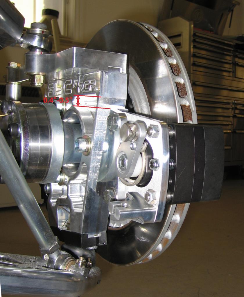

I mounted my e-brake calipers. Once you figure out where to locate the bracket on the spindle carrier, it just a lot of drilling, tapping and then mountain of aluminum filings to cleanup.
The bracket is located approximately flush with the side of the spindle carrier, and then toward the top of the vertical milled face. I've seen others locate it as high as it will go, but you can get a significantly larger brake pad contact patch by moving it down about 0.4"-0.5". If you move it too far down, the caliper housing rubs the disk.

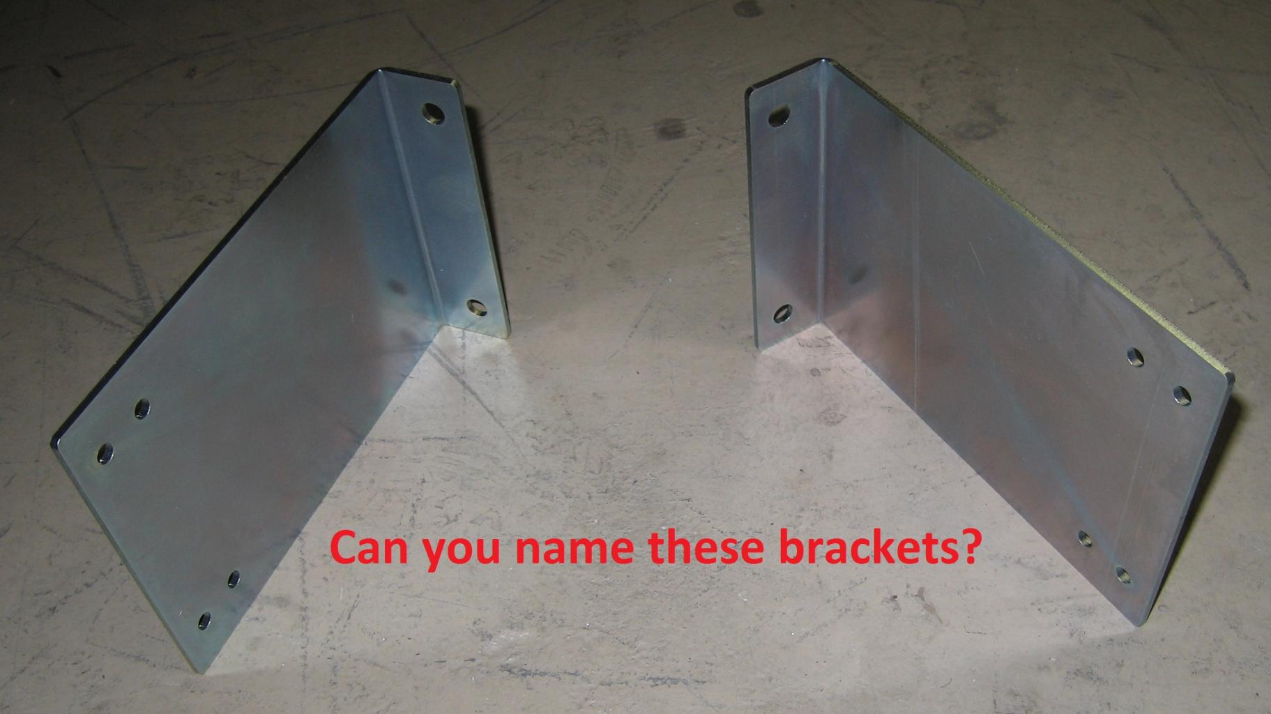

Question: There were 2 mystery brackets in my e-brake kit. Does anyone know what these brackets are for?
I'm told that the brackets are for mounting the e-brake handle. I don't have them, so they must be relatively new.

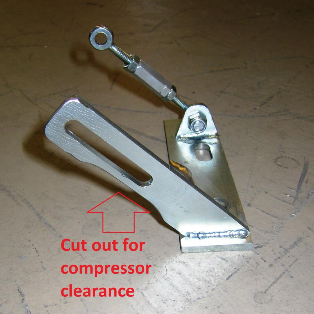

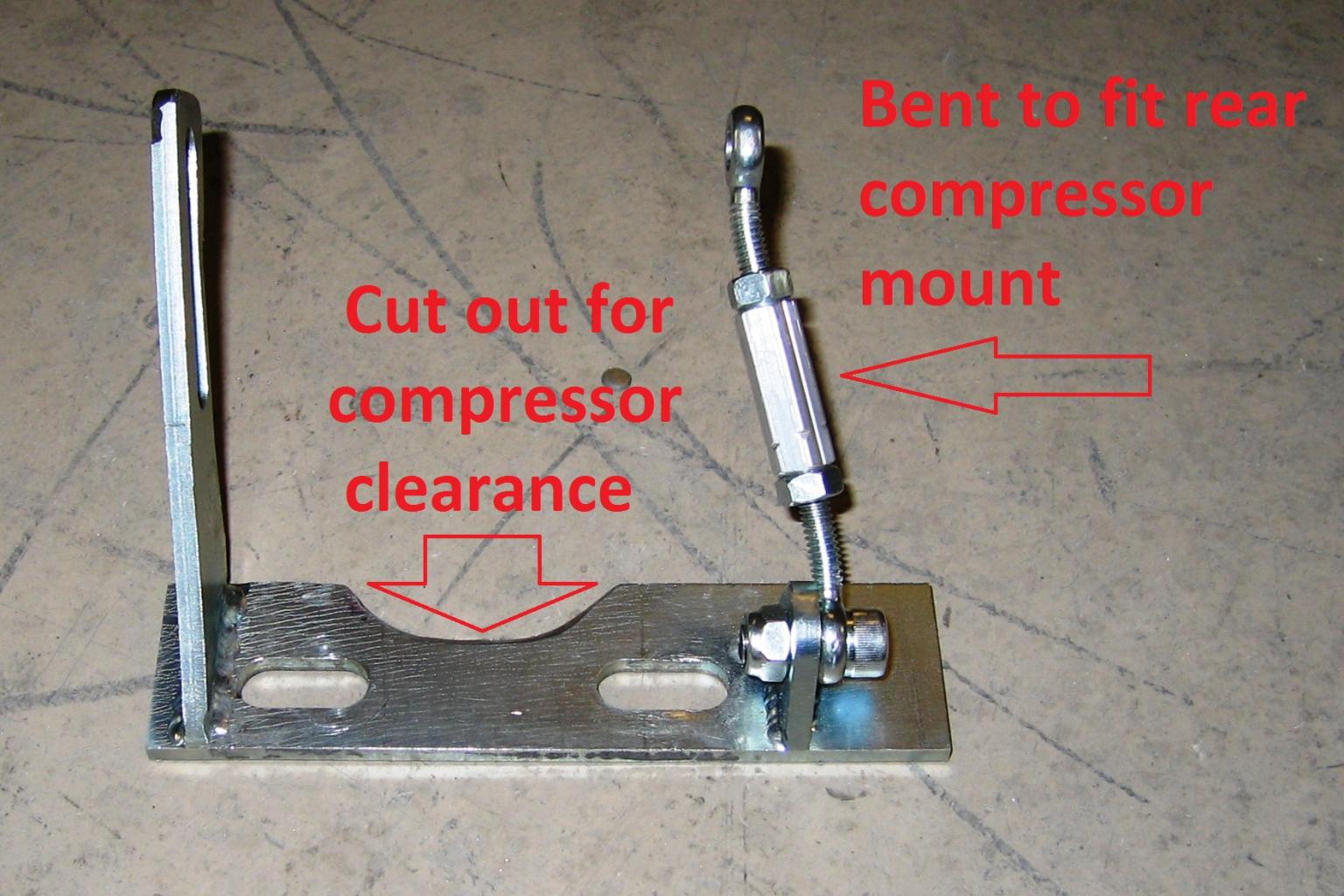

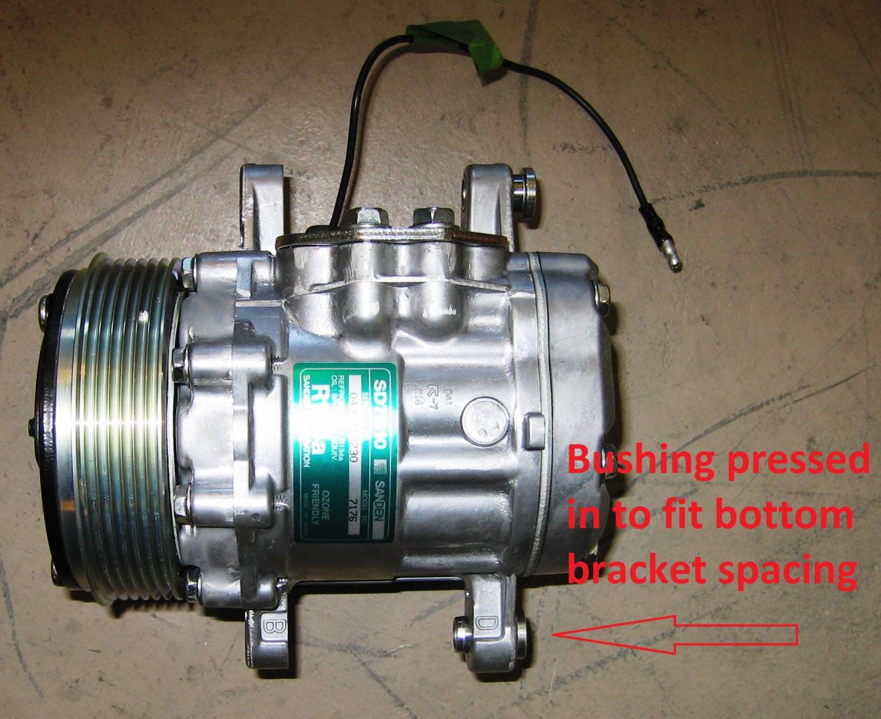

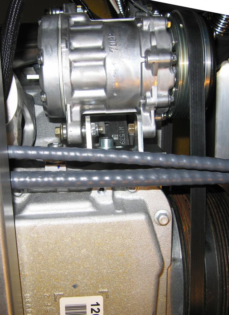

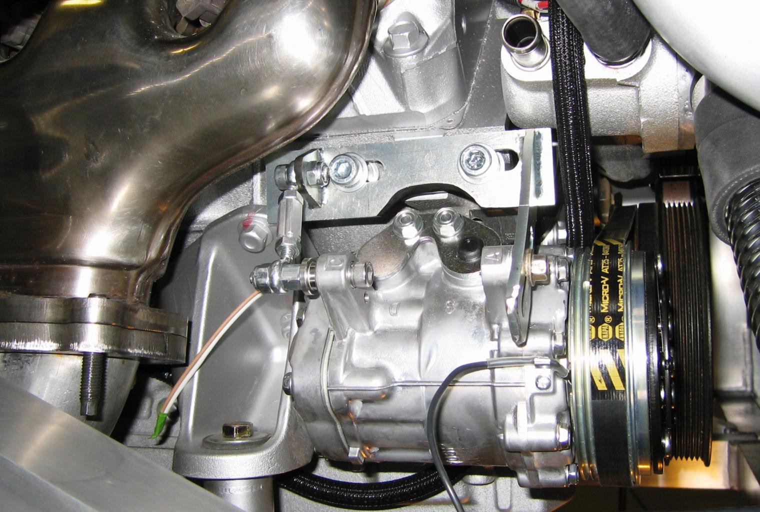

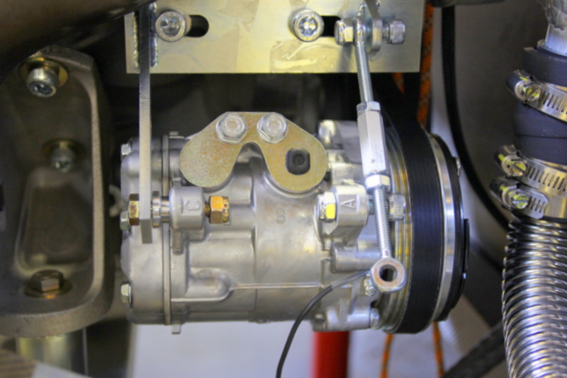

Got my AC compressor installed today.
The bottom bracket fits well and the belt alignment looks good. On the compressor, you need to push the press fitting in all the way for it to fit the bottom bracket spacing. Compressor installation was a bit difficult with the long bolt in the kit, so I replaced it with 2 shorter bolts.
The top bracket fits the front compressor mount, but requires some fine tuning. The bracket inhibits the upward swing of the compressor, so you can't get enough slack to climb the belt onto the pulley. I ground down the areas that were in the way, and that made all the difference.
The turnbuckle adjuster on the top bracket is not in alignment with rear mount of the compressor. I bent the ends and added a 1/2" threaded spacer to ensure the rear of the compressor is supported.
The belt that came with the kit was a little too long (Gates 040370), so I replaced it with a shorter Gates 040360.
All in all, it looks like a solid mount.

Ben sent me a PIC of his AC bracket. His is the mirror image of mine, and I think it's the correct side of the mirror. It allows space to put the turnbuckle on the inboard side of the bracket and aligns better with the compressor mount, so you don't have to bend it.
Bill,
Bens is in the correct orientation.....no bend and no clearancing should be required....
Brandon just checked the whole box of brackets and they are all correct...you got a lame duck...new one on its way to you today....sorry about that

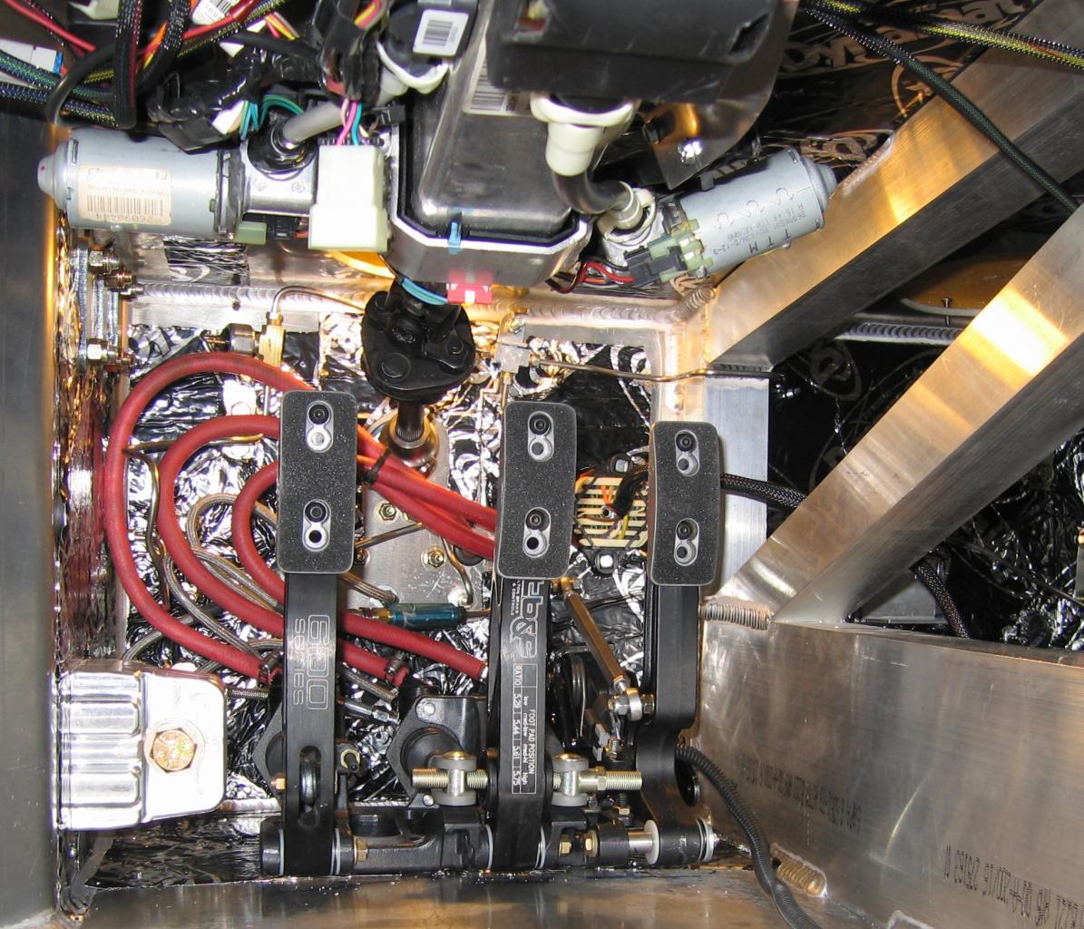

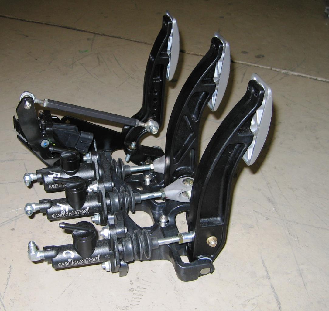

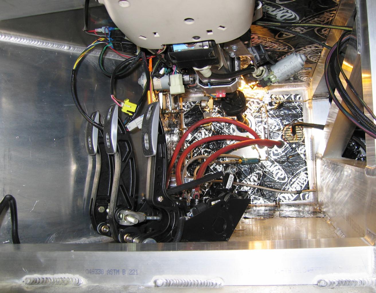

I finished installing my pedal assembly today.
I used the e-accelerator pedal from a 2010 Corvette and cutoff the excess pedal lever. I adapted the Tilton bracket that is for the GM Performance accelerator sensor and beefed it up to withstand the additional spring force of the Corvette pedal. I also removed the spring on the Tilton accelerator pedal. I worked out the leverage so its about the same pedal pressure as stock. I found a clevis assy in a local NASCAR salvage yard. Yup, here in the Mooresville NC (Race City USA) we have so many NASCAR teams, that we actually have NASCAR salvage yards.
I cut/adjusted the clutch and brake master cylinders so the pedal position would be in line with the accelerator. Then I bench bled the master cylinders before installation.
I tried a number of different positions for the pedals assy and settled on pushing them way into the foot box to about 1" from the end. I'm 5' 11" and my seat is all the way back, but that pedal position seemed about right for me. I simply drilled holes in the floor and solid mounted them.
I kept the full length of the brake lines and reservoir lines to allow lots of room to pull the pedal assy out for maintenance.
The modifications I made to the steering column really paid off. I moved up both the telescoping/tilt motors and cutoff the forward most portion of the column structure. Now there's lots of room to toss my tootsies to and fro!

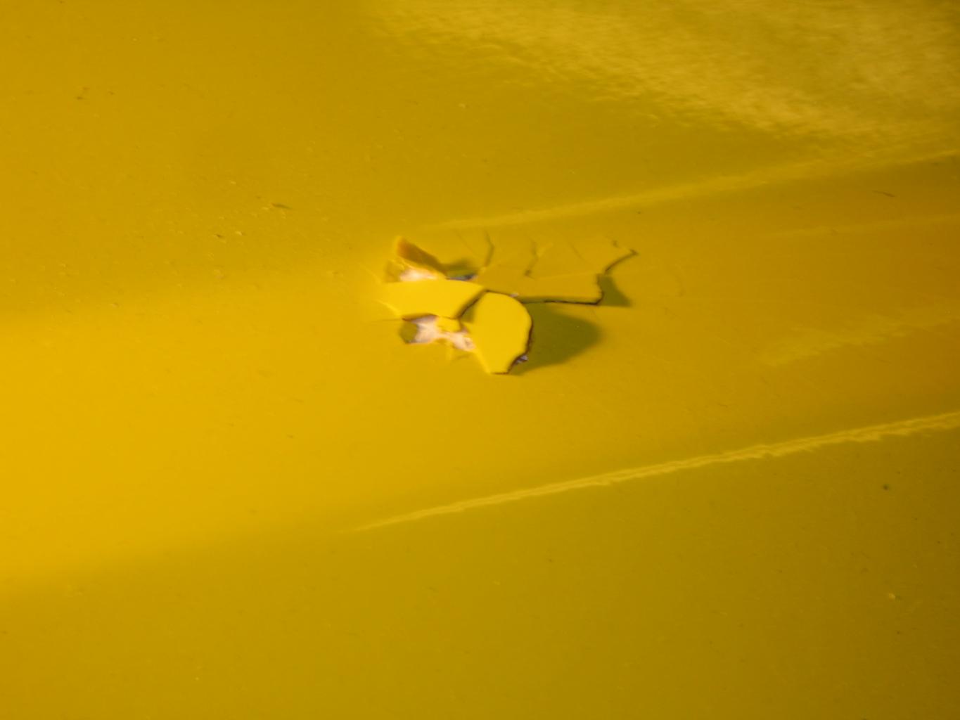

There was a hidden episode from way back on 2/1/13 of the reality show series. When my SLC was delivered, the body had suffered significant damage during transit. The nose had fallen off its shipping supports, so it was resting on the upright aluminum structure that holds the radiator. After riding in the pendulum end of a goose-neck trailer for 600 miles of mid-west pothole roads, those aluminum supports dug holes at the way thru the fiberglass! That's right, I had 2 holes in my front clam when it arrived...Yuk!
I gave Fran a call to see if there was anything that could be done. Fran quickly called Tony at Performance Fiberglass (Canadian manufacturer of the SLC body) and arranged for a repair. Fortunately, Tony happened to be passing thru NC and agreed to pickup my nose.
Just moments ago, Tony knocked on my front door and delivered the repaired front clam. It looks great!
Many thanks to Fran and Tony!

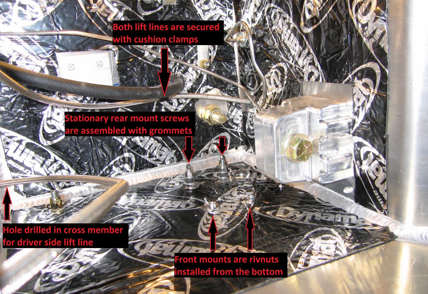

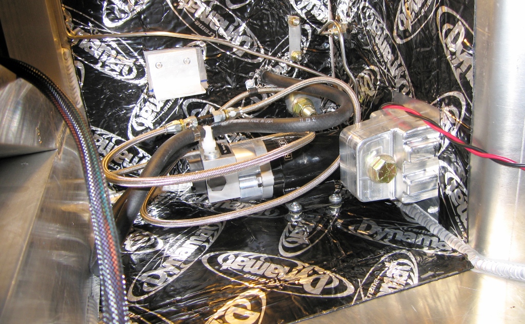

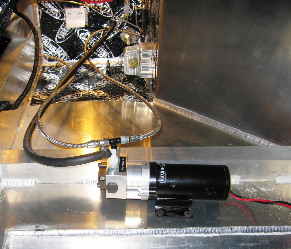

I finished installing my front lift system.
I mounted the lift rams on top of the coil springs so they don't move and to reduce un-sprung weight. The inside diameter of ram has a sharp edge while the coil over retainer cap has a rounded edge treatment. The result is that the coil over retainer cap doesn't quite fit flat against the ram. Fortunately, the Ram is made of aluminum, so its easy to mill. I used my trusty old wood router with a 1/4" round-over bit and guide bearing to round off the ram edge. Just be careful to take off only a very thin slice at a time.
I ran the ram lines thru a grommet into the footwell and secured each with cushion clamps. I drilled a hole in the chassis center support to run the driver side line into the passengers side, where the pump is.

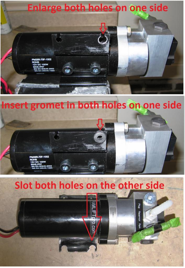

I mounted my lift pump far forward in the passenger footwell. I suspect the pump will be noisy, so I used rubber grommets to shock mount it and lots of dyna-mat. To make the pump easy to slide out for service:
  • On the front mounts, I secured long screws from the bottom of the floor, with a standoff nut and a rubber grommet. The front mounting holes on the pump were slotted to slide into the stationary grommets.
  • On the rear mounts, I installed riv-nuts from the bottom of the floor. The rear mounting holes on the pump were enlarged to accept grommets. Screws are run thru the grommets and into the backside of the riv-nut to capture the pump.
  • I left plenty of the AN pressure line and reservoir line extra length so I can slide the pump out with all the lines attached.
The ISIS electrical harness assumes that the pump will be mounted just behind the radiator, so the wires pass thru the footwell bulkhead connector. You will need cut the pink and gray wires from just behind the bulkhead connector and pull them out of the main harness to power the pump.
