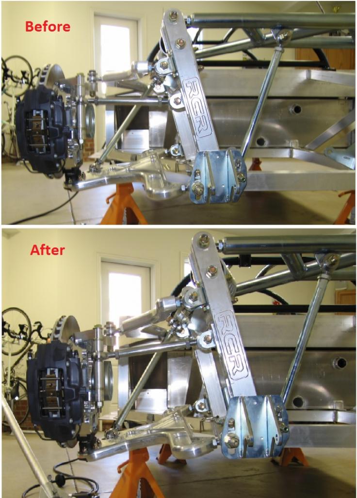

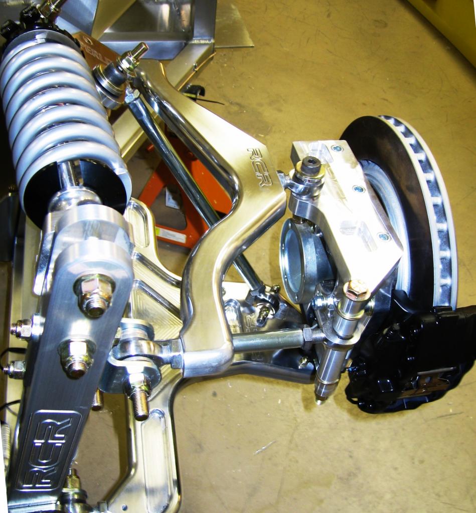

I finished the rear suspension.

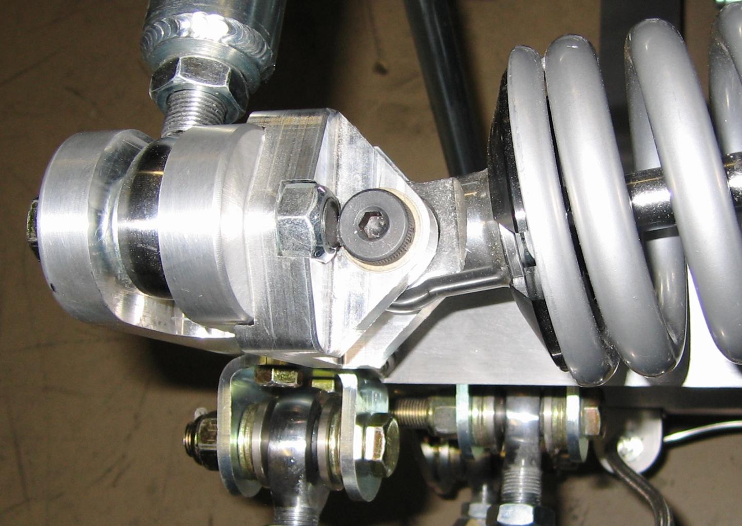

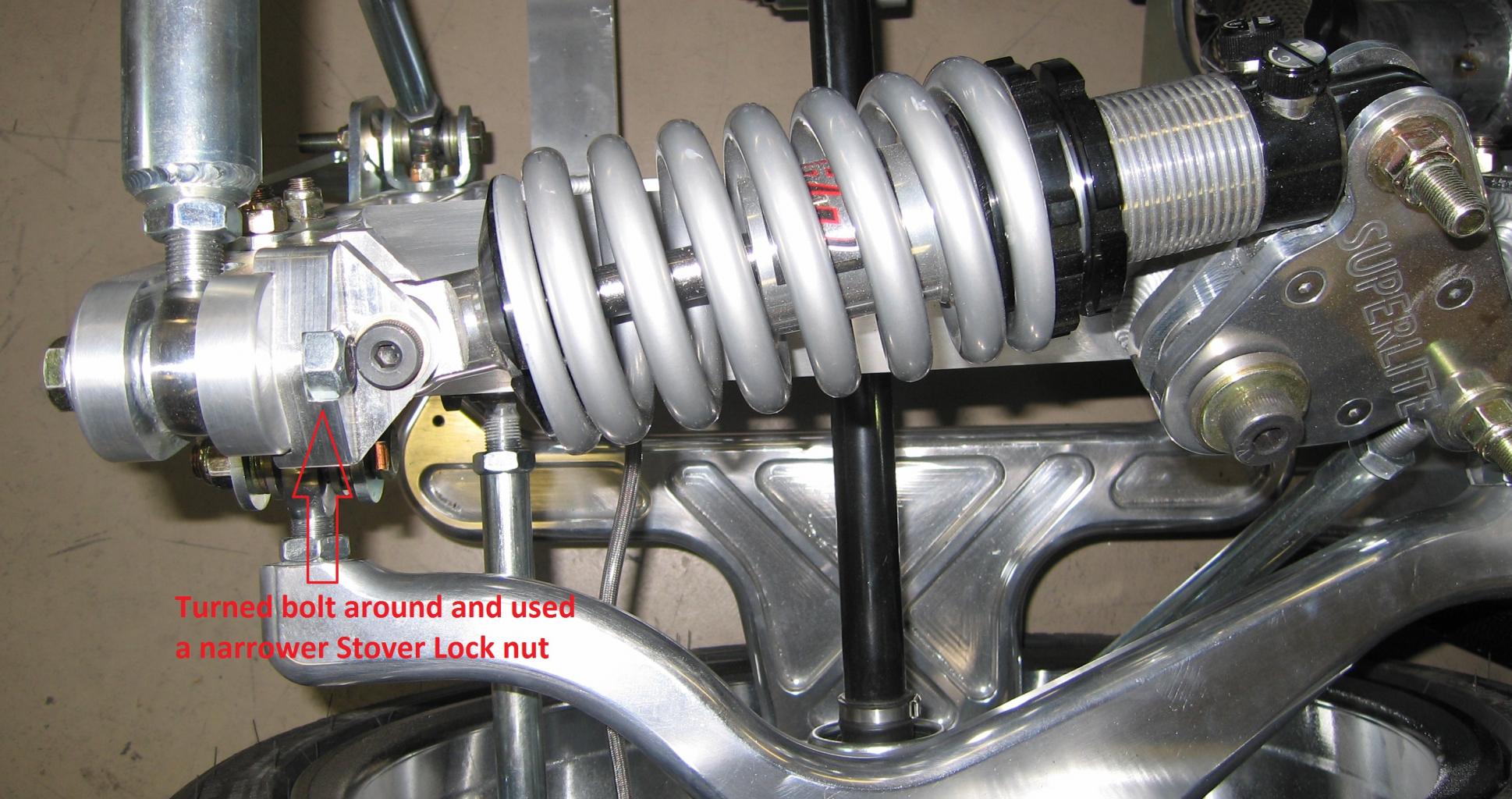

As I was pulling the suspension apart, I noticed that the bolt for the rear of the chassis brace was captured by the cap screw that secures the shock. That means the shock must be disassembled to remove the chassis brace. To fix that I cut the excess length off the bolt, I flipped it around, and then used a narrower "Stover" lock nut.

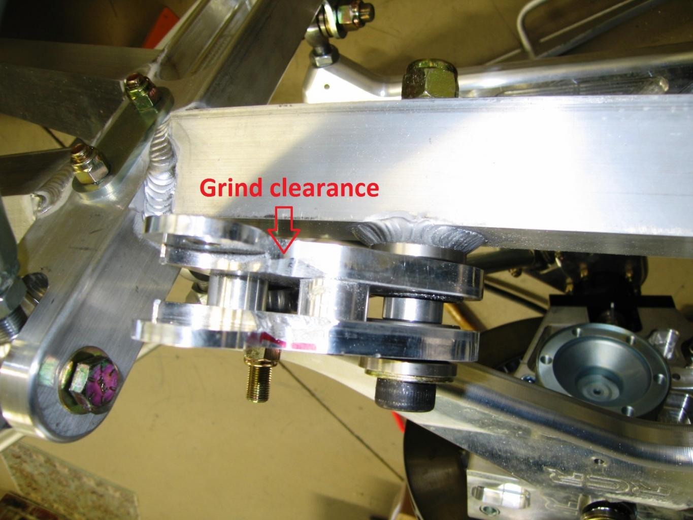

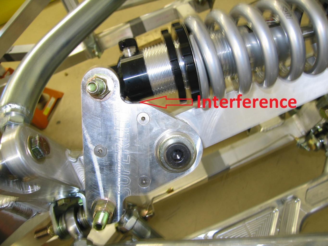

There seemed to be limited travel in the rear suspension:
  • When in full drupe, the shock was interfering with the bell crank, so I ground away part of the crank.

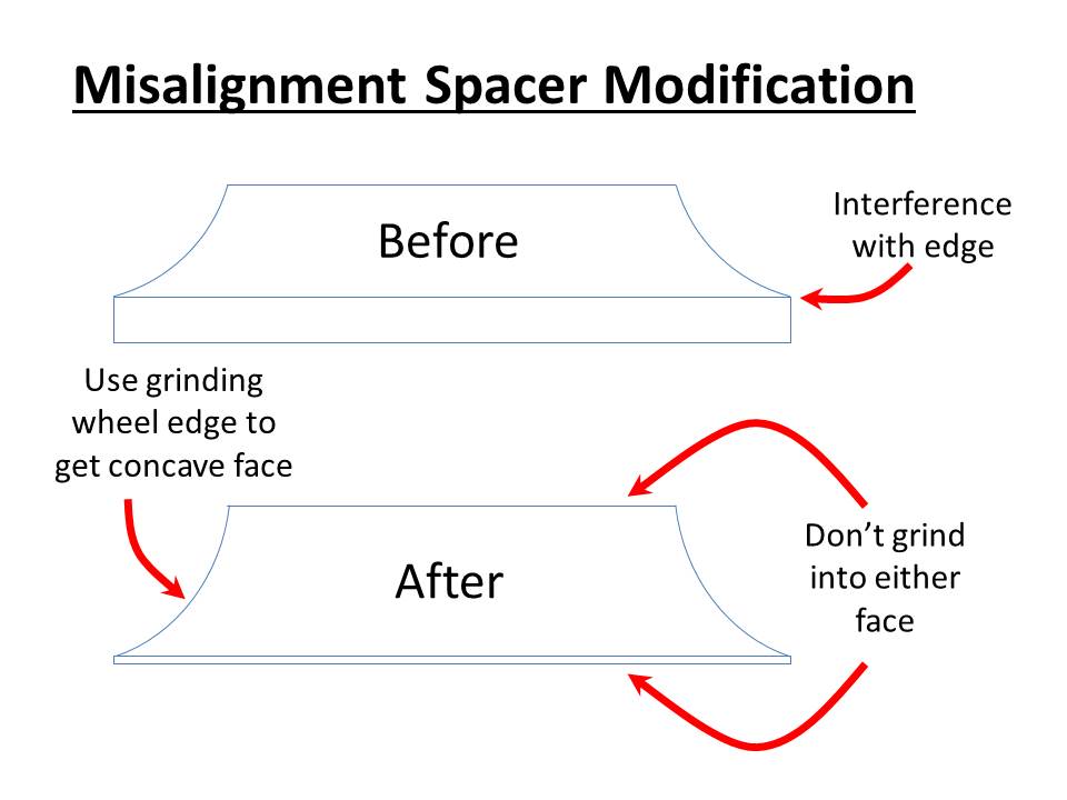

  • When fully compressed, the shoulder on the misalignment spacers were the problem again. As with the front suspension, I ground down the spacer side contour.
These minor modifications increased suspension travel 1.5".
I finished it off by sanding and polishing the a-arms in the rear as well...Bling!

Bill the stover lock nut MUST have the threads of the bolt completely pass thru it to be effective . The end of the nut is slightly oval (distorted). This area is the "locking" feature.
For extra insurance if you choose to leave it as is I'd use red or blue locktite on the threads.
I left the bolt in the stock position, but made a large 2-nut "washer" which I used to hold the safety wire that is keeping the nuts from backing off.
I like safety wire, and have used it extensively in the car. It gives a nice visual view of the condition of the fastener.
Bill,
Ken and others are absolutely correct....thread must come through the nut...as an ex aviation tech I am a little surprised that you dont have a at least one thread showing everywhere.
You are correct, that an aircraft quality check would flag it on a visual inspection.
The threads are not quite thru the nut, but I can tell you that it is thru enough to grab plenty of the locking end of the nut. I know its safe, but I can understand how it would make others nervous.
I replaced it with a slightly longer bolt...Don't tell my commanding officer.:lipsrsealed:

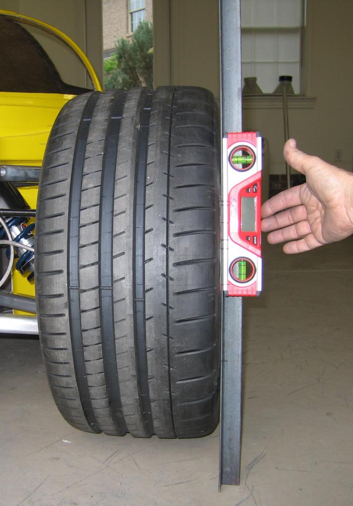

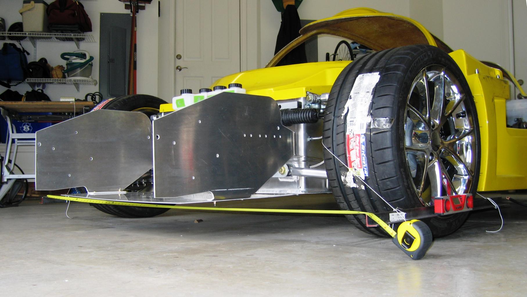

I finished my 4 wheel alignment.
I've seen lots of post for various ways to do an alignment. Here's my "down-home" alignment method. I get consistent results, but some of you hard core racers may want to turn away from your PC screen now.
All you really need is:
  • Some string
  • 2 angle Irons
  • Tape measure
  • Digital level

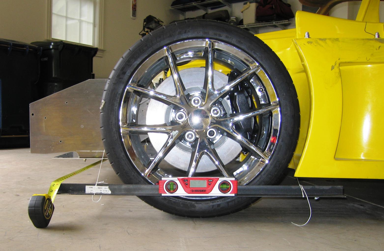

Of course, start on a level floor with the car at final ride height. The three measurements are:
  • Caster: Fran tells me that both the front and rear suspension geometry is setup with the 5 degree caster. As long as both a-arms have rod ends with about the same number of threads showing (front to rear), you will be very close to 5 degrees.

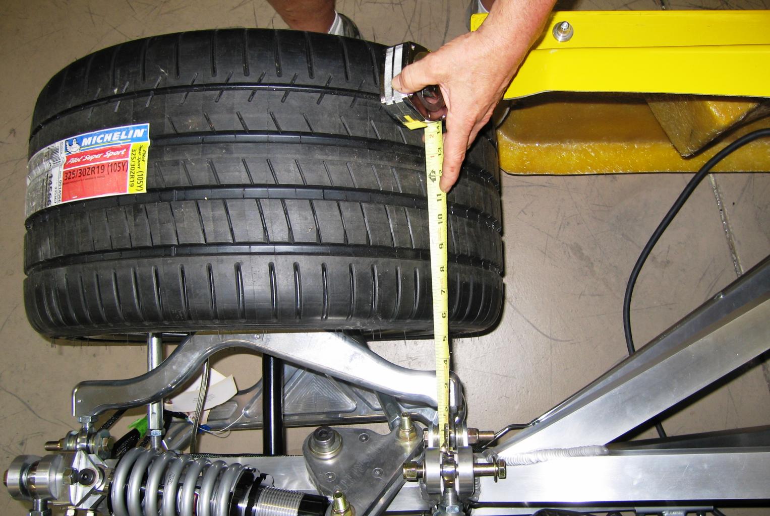

  • Camber: -1 degree camber can be measured with a digital level. Just place it on the sidewall of the tire, but back a bit from the bulge of where the tire contacts the floor. On my SLC, I needed to adjust the front upper a-arms out about 7 turns. The rear needed no adjustment. Be sure to check the that rod end threads still has the minimal safe depth via the peep hole on the under side of the a-arm.
  • Toe: Hang the angle iron over each tire using a piece of string. They should be hung so they are level, centered on the tire, and at a height that is higher than the bulge of the tire contact patch, but below the floor pan. This ensures the angle irons sit squarely on the tire and are at a level where you can measure the left/right distance under the car. You are looking for a slightly smaller measurement on the front vs the back of the tire for "Toe-in".
    • On the front, adjust the steering rod ends to get in spec.
    • On the rear, I found it easier to first adjust the overall toe using the stationary steering rod ends behind the spindle. Then you need to ensure the toe is centered on the frame. Just pick an easy reference point from the tire to the frame and ensure the distance is the same on both sides by turning the stationary steering rod ends an equal number of turns on both sides. Then double check your Toe to ensure it's still in spec.
Done!
