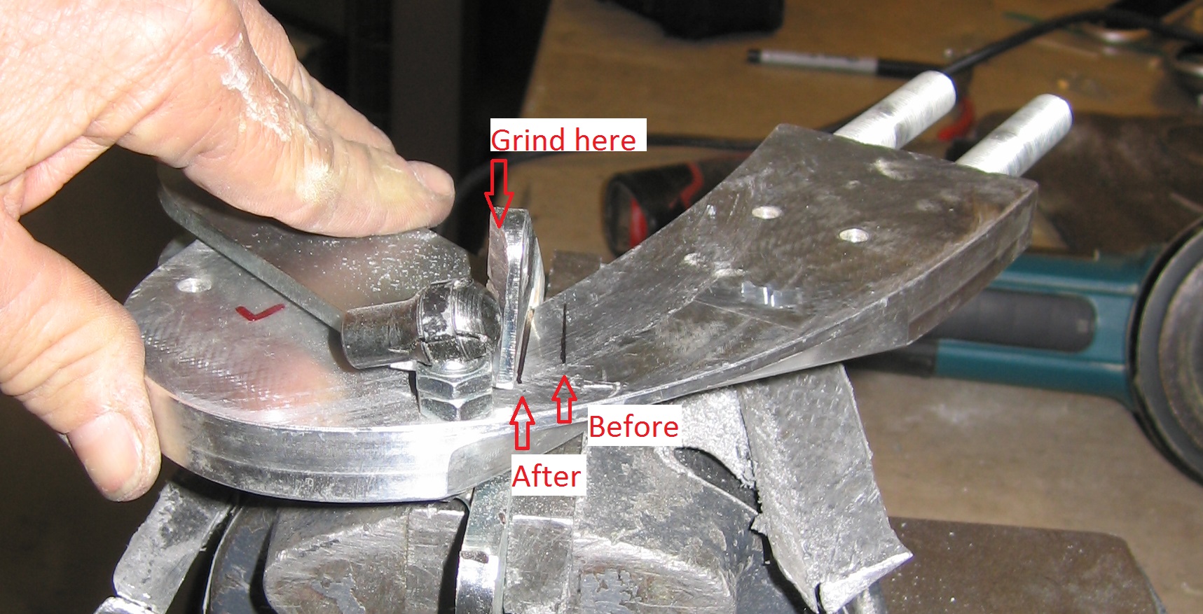

Here's a small detail that makes a big difference in the doors.
The gas shock end hits the lower door bracket when fully extended. If you grind down most of the interfering part of the bracket, the door will extend significantly further up. Just a 1/2" of additional hinge arm movement near the pivot point translates into significant movement at the end of the door. That makes it much easier to get in and out of the car.
Its important to leave a little of the bracket as a positive limit stop. Otherwise, the gas spring might punch thru and damage the fiberglass door jam.

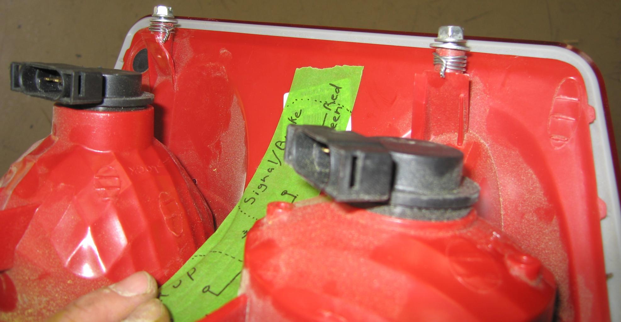

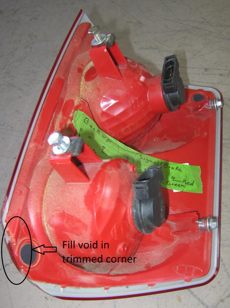

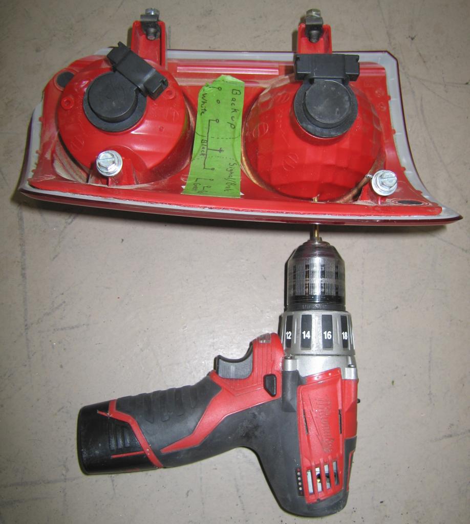

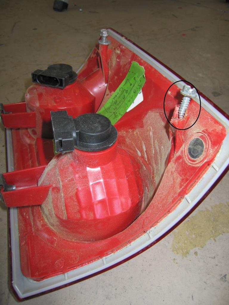

I'm in final bodywork and paint now, so I've been disassembling the body components, and the tail lights needed a little TLC.
  • The screws in the horizontal plastic mounting tabs were stripping out and/or splitting the plastic anchors apart. I used safety wire to prevent the plastic anchors from expanding and splitting. I used epoxy to fill the plastic anchors that had split and re-drilled them.
  • I replaced the vertical anchors with 1/4-20 nutplates for a more secure mount.
  • To fit the Dakota tail lights to the SLC, you need to trim the outside upper corner. That leaves a void where water could enter. I just used some epoxy to seal the hole.
  • If any water does get into the light fixture, I drilled weep holes into the bottom of each lens. The bottom of the inboard reverse light cannot be accessed, so I drilled thru the bottom to get to it. These holes are not visible once the tail light valance is in place.
  • I added a label to each light fixture with the electrical connections. I had been told that the Dorman RNB-85885 Tail Lamp connector would fit the tail light. I ordered them and they did not fit. Does anyone have the correct part number for the Dakota Tail Lamp connector?

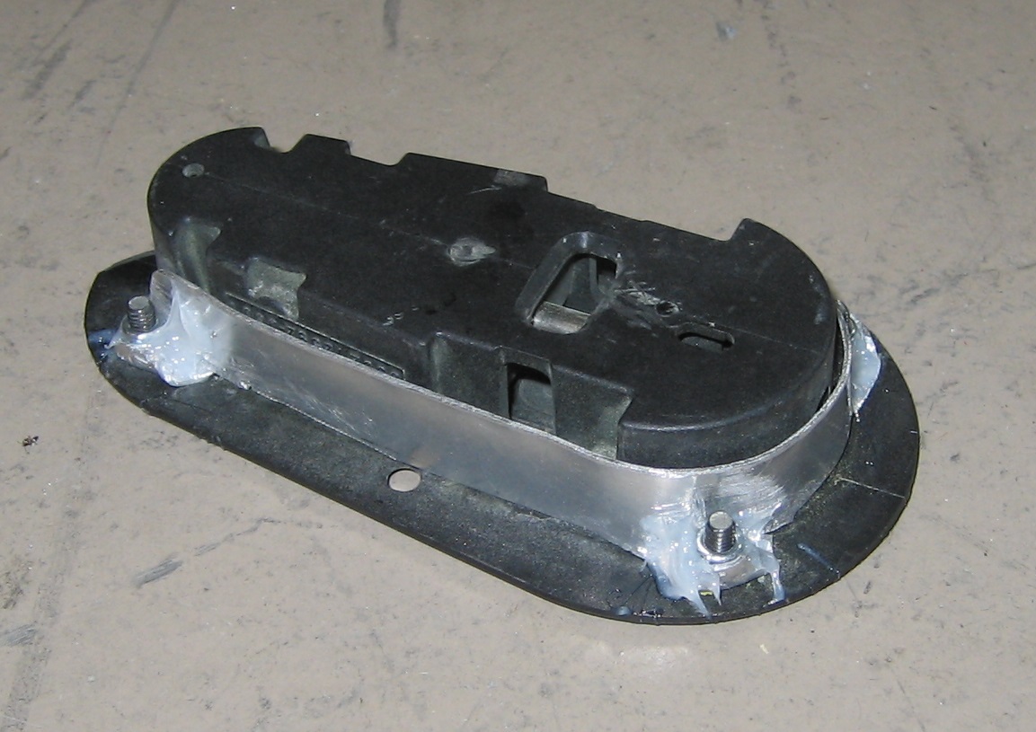

Each time I work on a particular part of my SLC, I try to make it easier to do that task the next time.
As I disassemble the body for paint, I had to remove the front clam latches. Removing/installing the front clam latches are one of the most difficult tasks on the entire SLC, particularly when the body is mounted on the chassis. It takes a contortionist reach from under the car to even get to the backside of the latch. And then the tiny mounting nuts are sandwiched in a small sliver of space between the latch and the fiberglass body. That small sliver of space is nearly to small to get a socket or wrench on the nuts...Argggg!
To make this task much easier, I fabricated a simple nut plate that I can hold in place by sticking my fingers thru the latch hole on top. Its just a scrap piece of .040" aluminum sheet that is bent tightly around the nuts and some epoxy to hold the nuts firmly. After this photo, I cleaned up the epoxy and painted the nut plate black, since it can be seen thru the latch hole on top.
There is no need for these nut plates on the rear latches, because they are easy to reach.
