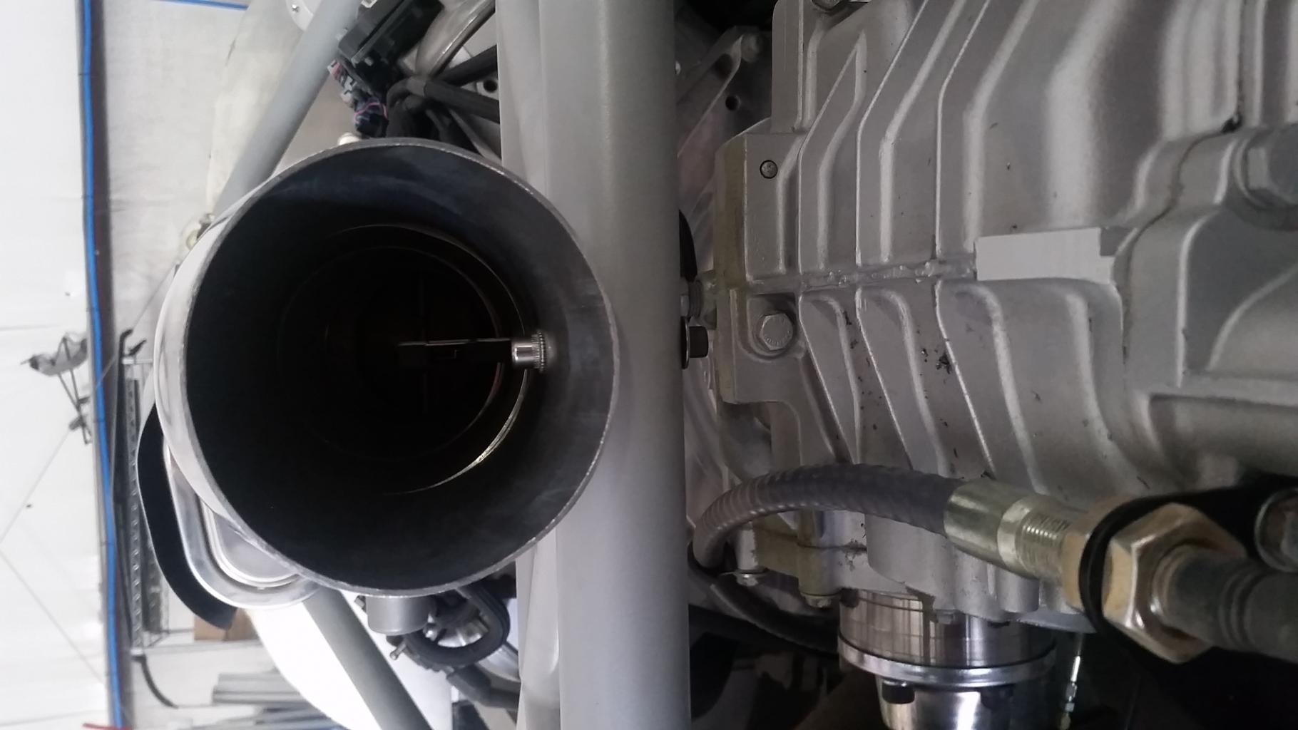

A while back someone asked how to mount the air intake tubing (sorry I don't remember what thread it was).
I prefer simple fixes, so here is how I did it. Just drill a 1/4" hole up thru the X-brace and install a riv-nut on the intake tube. I wouldn't use a nut inside the intake tube because if it ever comes loose, you will have your own Chitty-Chitty-Bang-Bang.

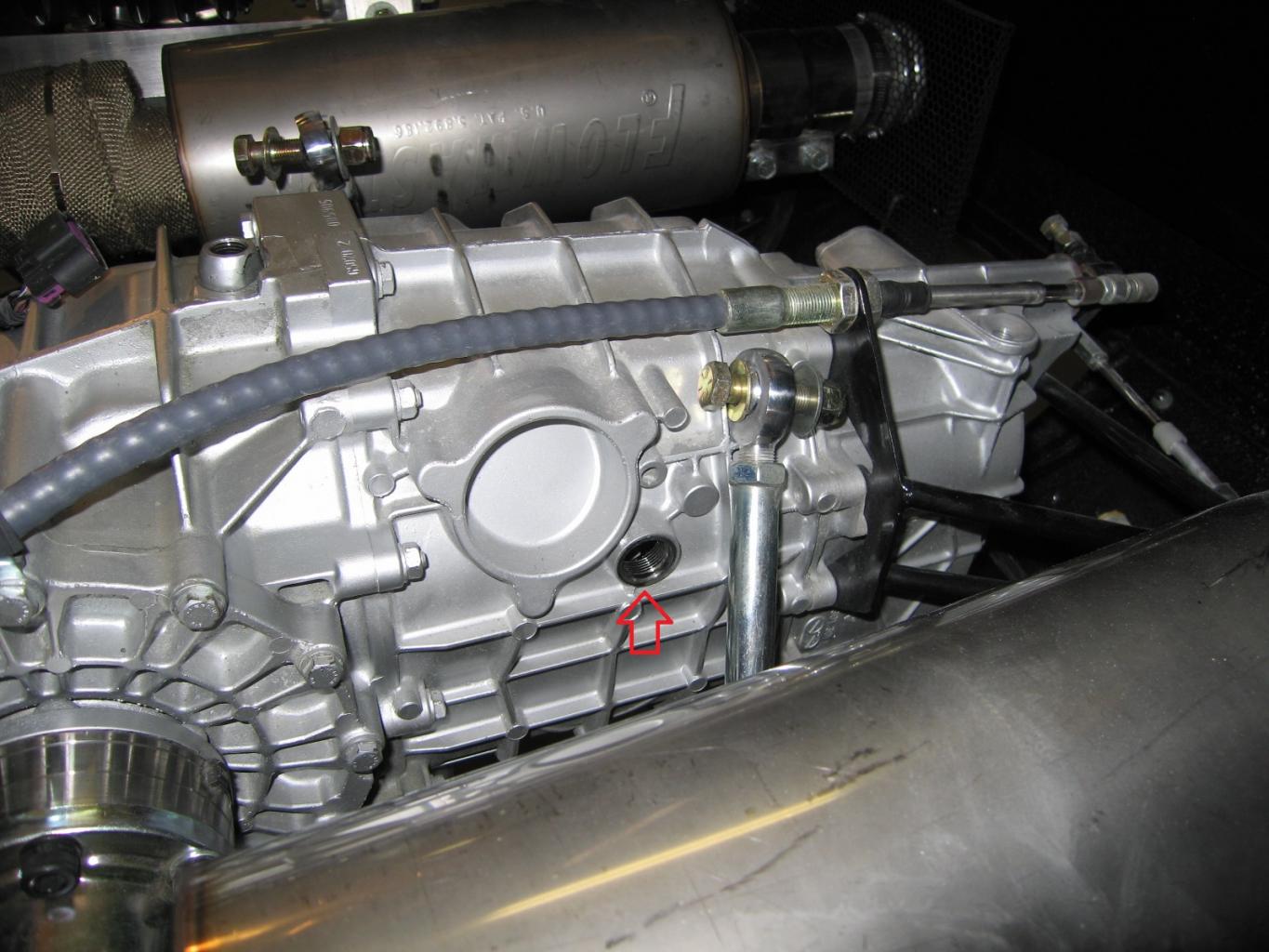

Yup, I added a vent way back when I prepped the transaxle.
Basically, I converted the drain plug to a vent and the vent to magnetic drain plug (not shown in PIC below).

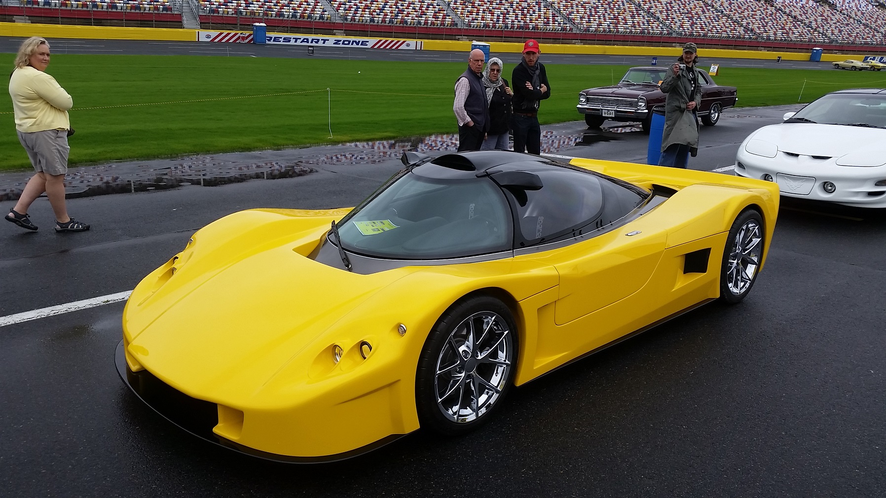

It took many long hours over the past few weeks, but we were able to debut my SLC at the Charlotte AutoFair this weekend. There were several work days that extended into 2AM - 5AM in the morning!
Unfortunately, it rained the entire weekend. I still drove my SLC to the Charlotte AutoFair and took the opportunity to water check my weatherstripping.
The Charlotte AutoFair is one of the largest shows in the USA, and I'm proud to announce that my SLC won a Top 5 Trophy!
Here's a few phone PICs. I'll get some better PICs when the sun decides comes out again.
