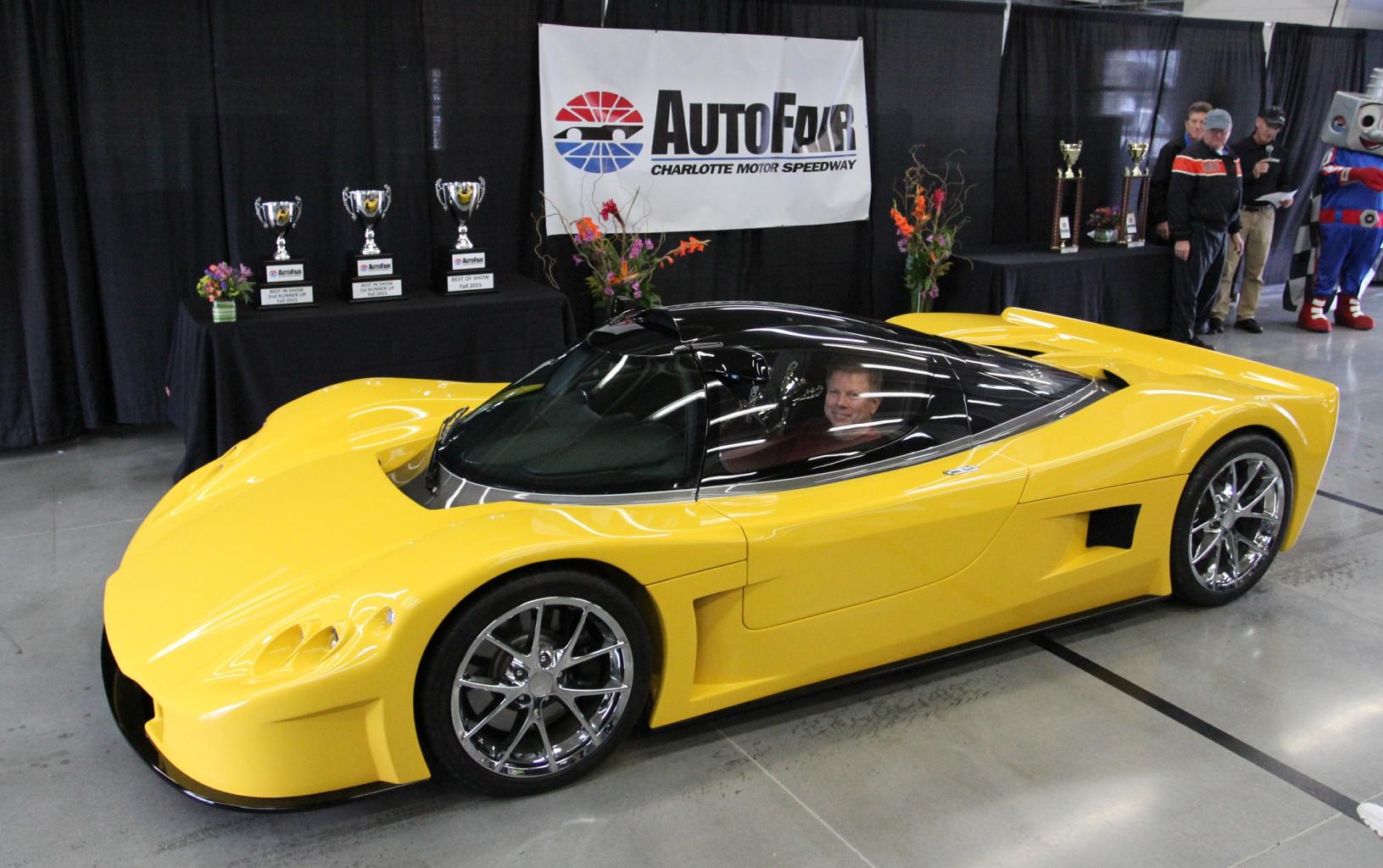

Pam and I were there this morning around 10. The car looked great, even in the rain.
Congrats on the top 5 trophy, and sorry we missed seeing you there.
The car looks great! Excellent fit and finish, and too bad it rained so you couldn't display your great interior!
Hope your sealing worked...I drove mine yesterday and got caught out in the rain. Still a dry interior, and other than a bit of cleaning, no apparent effects. I think I will add some more to direct the water so it flows exactly where I would like it.
Bill,
Congratulations... What a beautiful car! I too love the black top also. I also like how you have the side windows placed without screws. How did you make that happen?
Bill,
In addition to the side window install, I had another question. In your body prep and in the pics of your finished car, I noticed you didn't have a rear diffuser in place. I was thinking of making my diffuser removable so I could get the rear bonnet open completely. Is that what you are doing too?
This is the first yellow car I've ever liked. Excellent finish! It looks very good with the two tone top and bottom. It reminds me of the 458s that are painted similarly.
Gee Bill, That is unquestionably the best looking yellow car I have ever seen. All that hard work has paid off big-time. I hope you really enjoy the success you have created.

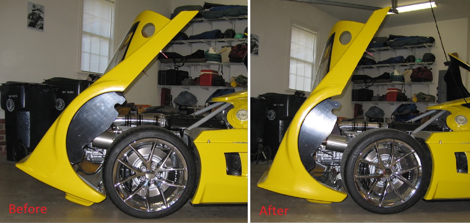

The PIC is a little dark under the car and its hard to see, but if you look close the rear diffuser is installed. Way back I got all medieval, grabbed a saw and cut my diffuser out of the rear clam. I trimmed the bumper portion of it off and re-mounted it about 2" further forward.
I always thought that the diffuser stuck out too far, so this change really tightens up the way the rear looks. It also allows the rear clam to tip much further rearward.
A bonus is that the separate diffuser piece can be easily removed when you need to work on the rear of your transaxle.

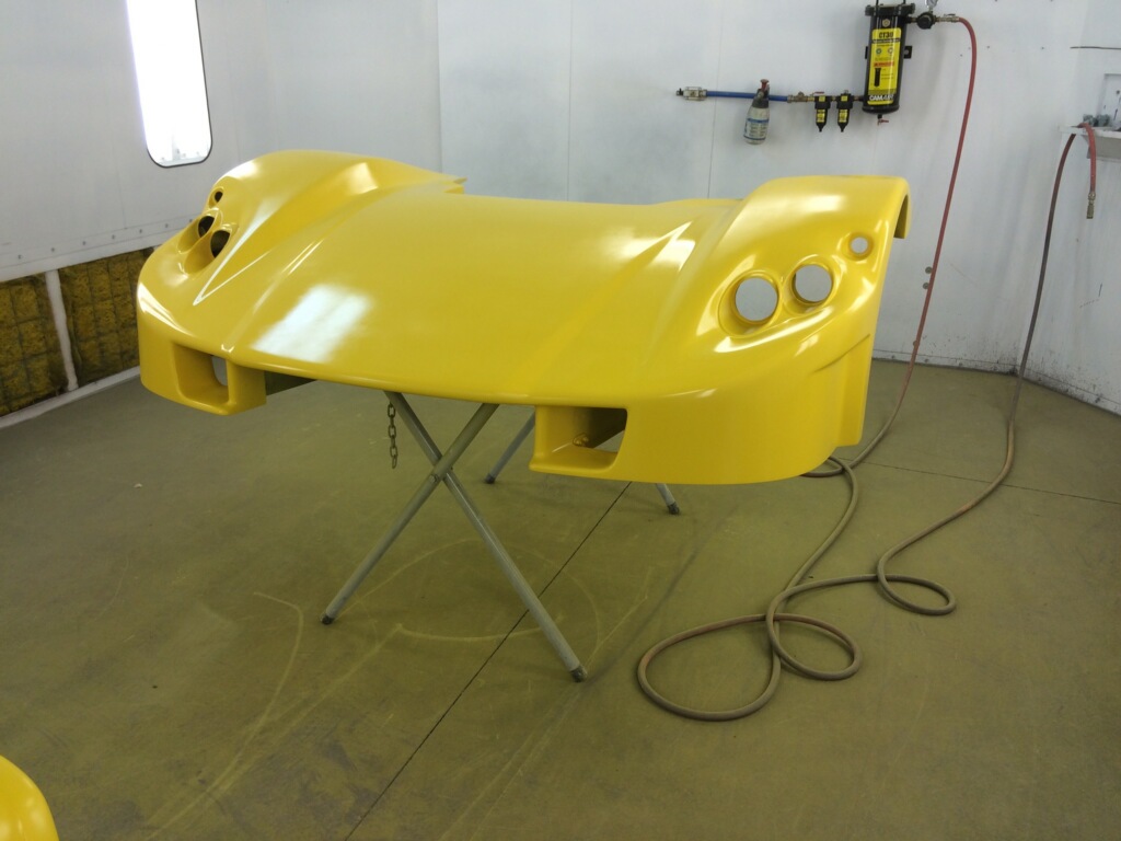

Are you intending to leave off the headlight covers? It doesn't look bad that way, just curious as it seems everyone else uses them.
I decided to omit the lexan headlight covers and smooth out the cover outline in the body. It gives the front end a Pagani Huayra look.
