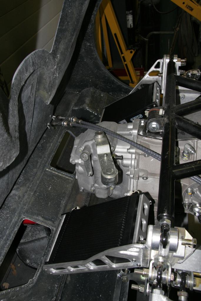

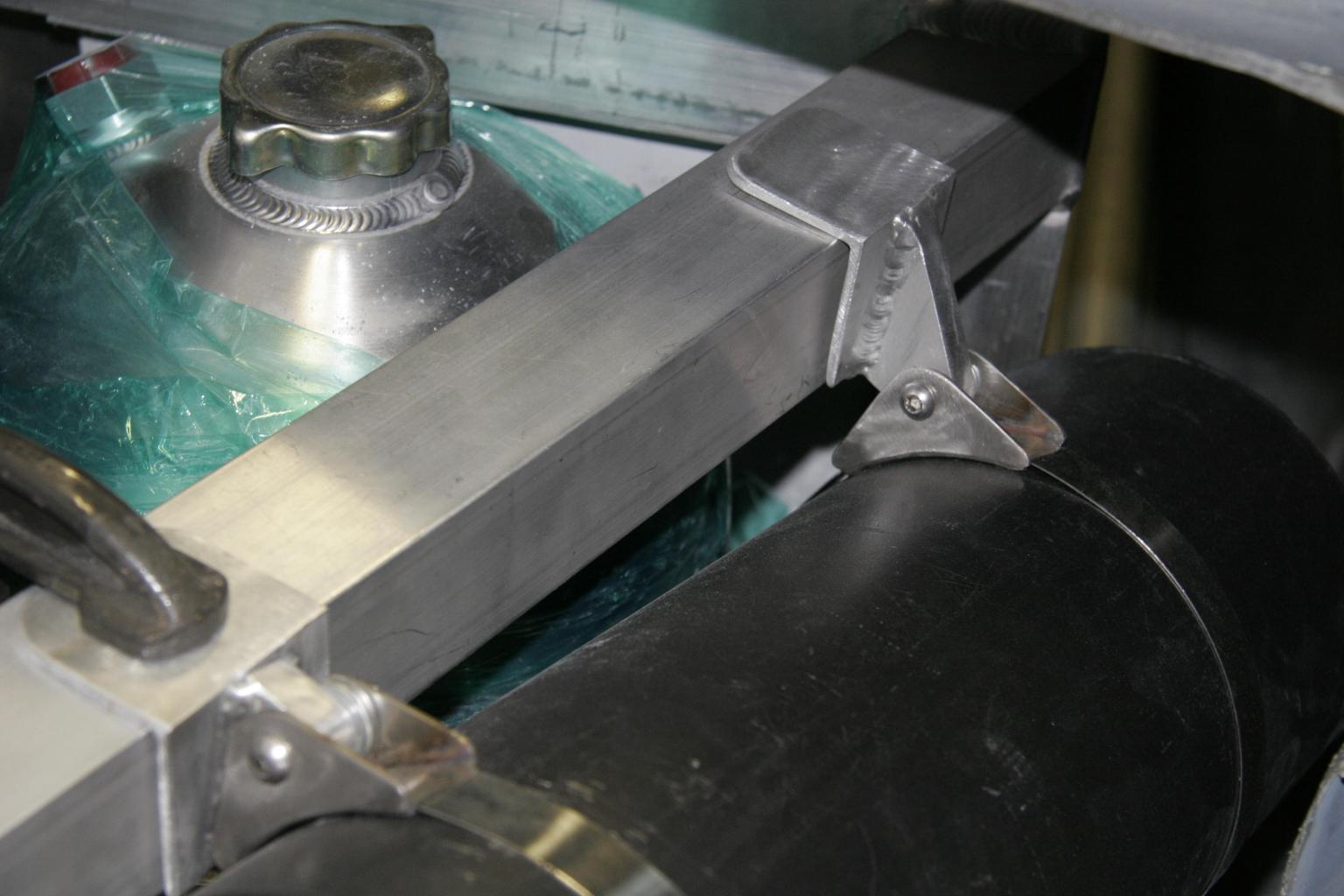

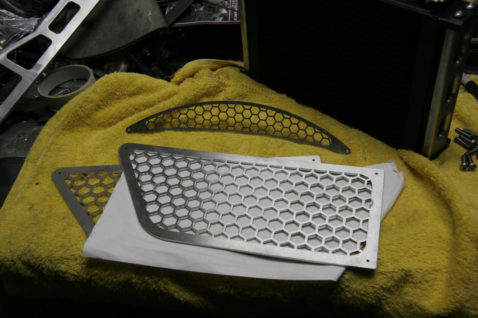

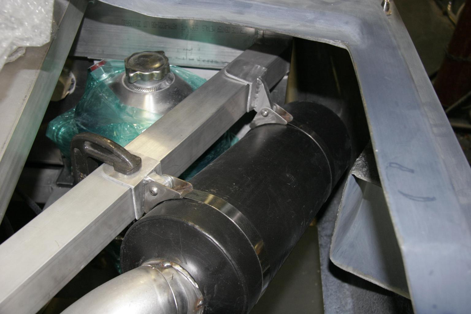

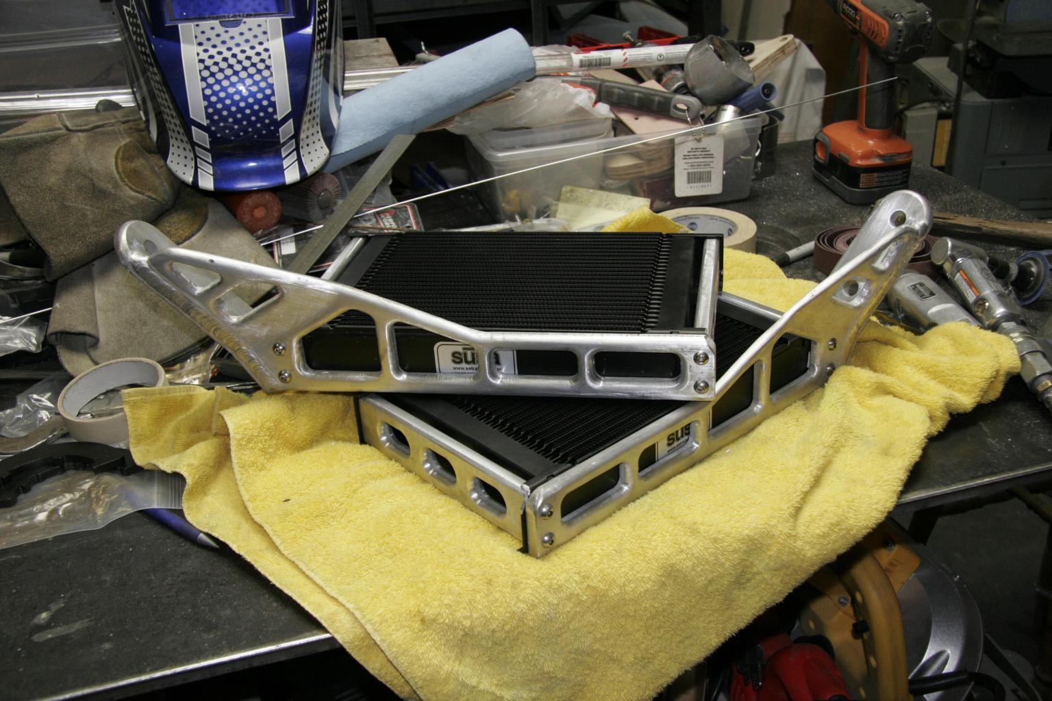

Shark, We have an industrial toy store here called Greggs distributing they have pretty much everything you can think of, these are just HD Stainless 6" hose clamps it's the brackets that you will have to make I have them drawn up in CAD along with most everything else I have fabricated for the car if needed I can email them to you but you will need CAD to open the files. I have made some custom oil cooler mounts as well to the Setrab coolers that work great if you are going out the sides with your exhaust this should work well I am hoping the draft from under the car will flow throw these with out any help of shrouds or fans. Also I have drawn up a complete set of screens for the inlets and rear, I haven't had the side vents laser cut yet as I might modifiy them to incorporate heat shields as well as for the air intake ports at top rear of the clam I have them drawn up as well but I am working on a cold air box and they might be reworked. Here are some pic's.

The screens for the air inlets look great! I'd like to see what they look like once get a chance to install them.
They certainly look like strong parts Grant...make sure to rubber mount the coolers....they fail quickly/easily unless you do....
Heatshields around your mufflers too....air is a great insulator...so having a small airgap will really help keep the muffler heat soak down....

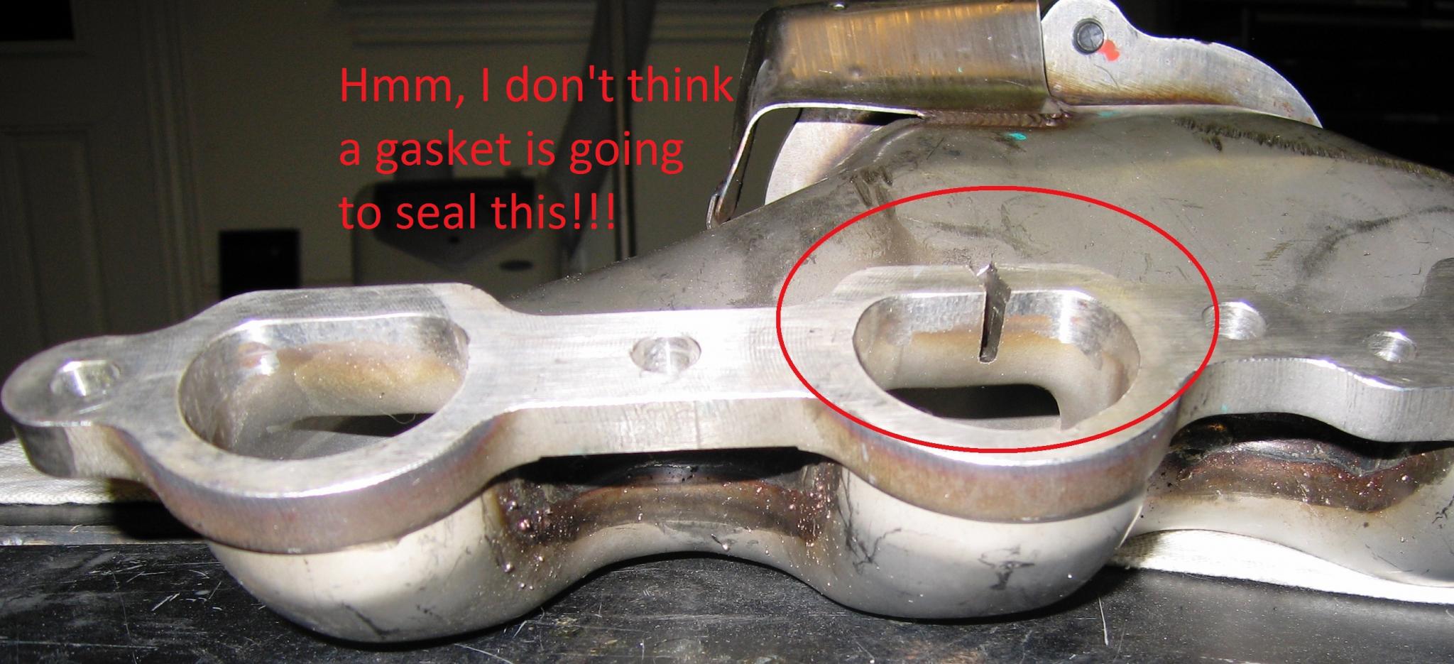

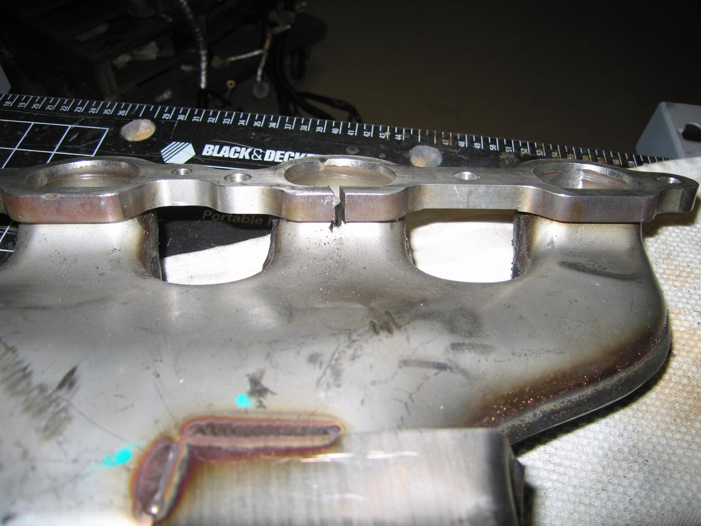

Speaking of LS7 headers, I just got mine installed. I found a new "undamaged" pair on eBay for $150, and ordered them over 3 weeks ago. When the headers arrived, I wondered if the seller was "Hockey Mask" Jason. You know, the guy with a chainsaw fetish. You can see in the PICs the giant gash in the port flange...That's gotta hurt!
The Seller did the right thing and sent me a new pair, but it took a while to resolve.
I dry polished the stainless steel headers. Now she's all dressed up, but has nowhere to go....yet

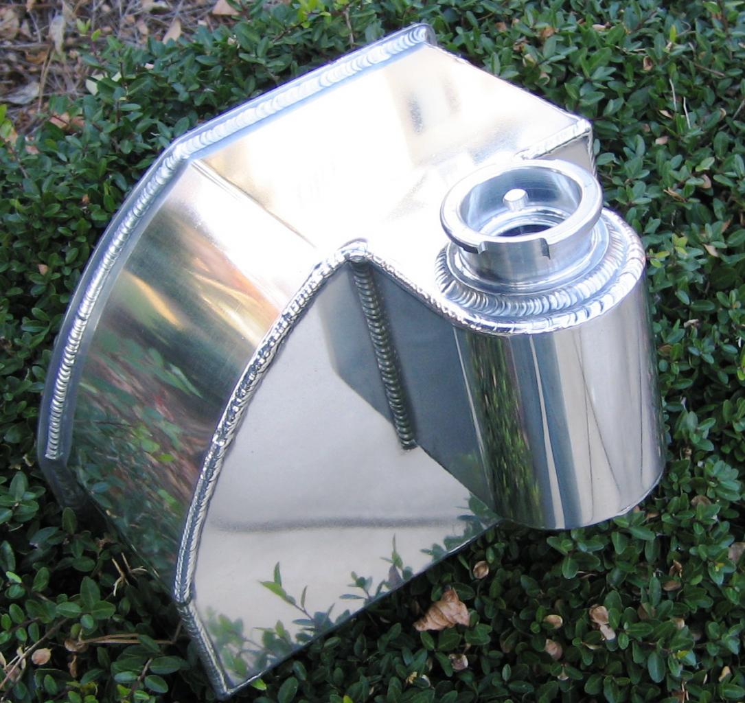

Looking good - I still wonder about your waterpump routing on the d/s ..... the amount you have to go up almost makes it the high point in the system. Might make it either very difficult to bleed or very difficult to access a remote fill/expansion tank.
Alex,
You may be right. I'm going to try it, but I may have to change it when I get my SLC kit and mock up the engine mounts.
Wow Bill makes you wonder what he was thinking to do that, pretty nasty glad to hear that it all work out.

Thanks for the tips Fran, I have plans for heat shields and will be cerma-coating the entire system once it is completed I also have thermo wrap for most of it.
As for the coolers, The brackets are not totally ridged and have a fair bit if lateral flex
the two brackets running the width are only to support the loose side. I haven't dealt with set up like this before so I will take heed and rubber mount them If you figure I should. Doing so may require an extra bracket to the unsupported side to stop them from moving to much.

Those LS7 manifolds polished up nicely. Probably the most bang for the buck of any part you could buy. Brand new take-offs are usually available on ebay for $175-200 for the pair.
