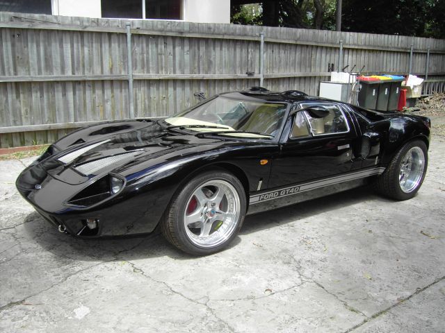

Hi all

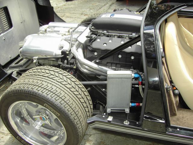

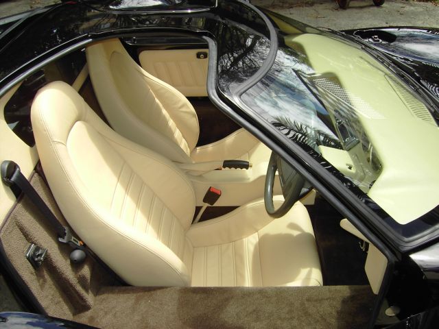

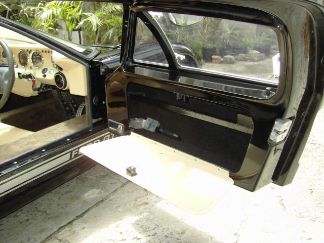

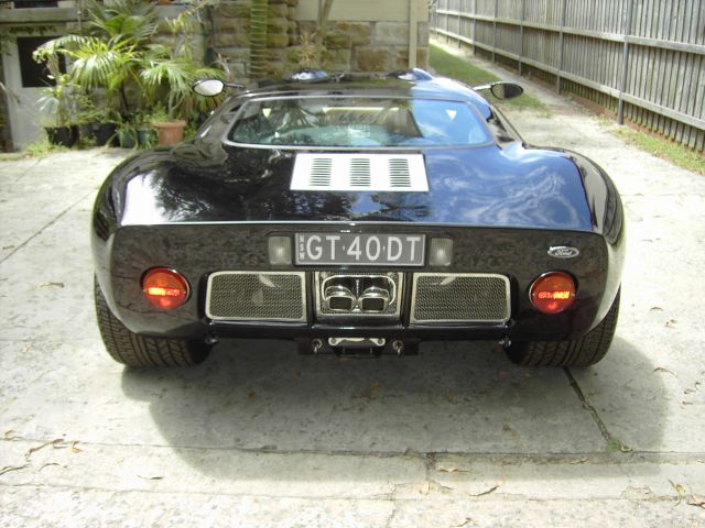

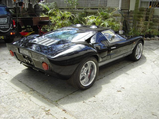

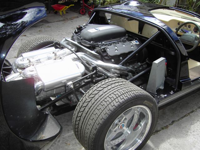

The big day has finally come and DRB#68 is finally finished and fully functional.
Tomorrow morning I will be going for a pink slip and then to the RTA for a temporary 30 day permit to allow me to drive for the weighing and the road testing by my engineer and the final rego.
Yee Ha.
My first road drive.
I have included photos of the finished car.
The only thing I need to fit is the filler caps and the screws for the front hatch which will be done shortly.
Dimi

Dimi I have loved reading your build thread - plenty of great pictures, but also plenty of clever and original ideas. The finished product looks great. The interior looks truly awesome, and your car just flat out looks BAD! (in a good way). Good luck with the tests.

Dimi,
Congrats on the fine accomplishment. I know you are excited and worried at the same time. I was the first time I drove my Lotus Esprit. Waiting for so long a time to finish the 40 will multiply those feelings due to the energy put into it. Be sure to enjoy it. That feeling won't happen again for a while. Soon you will be driving it like it is a part of you. Congratulations again on a superb build.

Dimi,
You've done an outstanding job of creating a spectacular GT40. Your car looks like one that could actually be driven and enjoyed on a daily basis without feeling exhausted afterwards. The interior is a beautiful modernization on the theme as well. I hope you post some more high-res pics in the gallery section.
Well done!

Demi,
Your car presents itself extremely well. Your level of engineering and craftsmanship are truly magnificent!
I am a true blue original kind of guy from the word go. Your departure from "oh my god" original to your finished product has completely changed my mind about the idea of originality. I truly love the color choice, especially your interior color and how your upholstery is finished. It just looks right!!!!
I hope someone at Ford has an opportunity to see these pictures, or better yet, sees it in person. Your finished product deserves an award in my opinion, and it sure would be nice to have that recognition come from the blue oval guys.
Job well done!!!!
