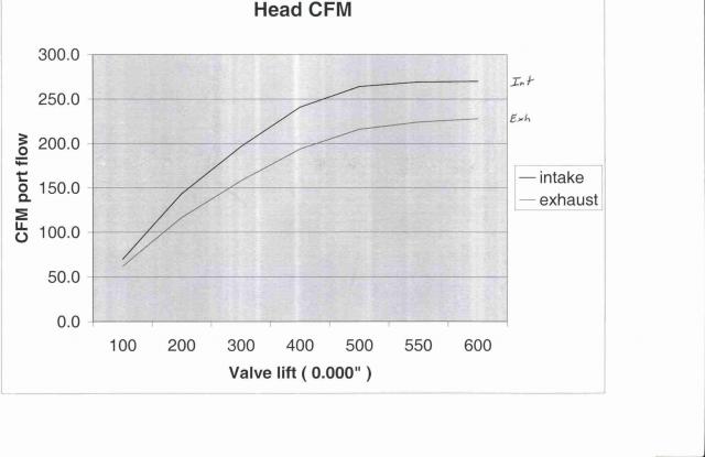

The motor is a 1967 289CID, bored 030 and stroked by using a 302 crank. Total cubes now are 306CID. The heads are custom made aluminum pieces from Livernois Motorsports (bench flow graph below). Kieth Black high dome pistons. Didn't volume the assembly, so can only speculate the comp ratio to be about ~10:1. Cam is a TFS with cam lifts of Int 0.312/exh 0.319 (with the 1.7 rockers I-0.530"/E-0.542"). Full roller valve train, and of course, the ubiquitous Webers (as Alain de Cadene would say :-)

Chuck, correct, am also running the IDFs. I'm running 175 mains, F11 imulsions, 180 air correctors, 55 idles. As mentioned, it is a touch on the rich side. Probably could get a couple more HPs out of it with a drop to 170 mains, but since it's not for me.....I'll keep her on the rich side. A little insurance for me....they tend to go boom when they're fat..:D I don't want any phone calls later. If the new owner wants to get max HPs, he can change em. Post your jetting info on your log, and we can noodle it.

That's pretty interesting. I have a 302, at about 9.2 to 1, Holley 750DP, FMS X303 alum heads with a bit of pocket porting, and a bit less cam, B303. I came out at 283HP at the wheels and 290ft/lb torque. Very close really. It's still my target to get to 1HP/inch on the chassis dyno some day. That seams to be a good target for a NA motor on pump gas. My guess is my motor is making about 350HP at the flywheel. Yours must be around 375-385. That's a really good number to put into a GT40. I bet it is really nicely balanced grip to power wise on track.

Sounds like your turning some good numbers, especially for a 9.2:1 motor. You can certainly be happy with those. What fuel were you running?
I agree the 1HP to 1 cube is always my target too. I know I could exceed this if I wanted to with this engine, but again, built for robustness, not peak performance. I could go up a little more on timing, dial in the mixtures closer, play with the carb linkage some more (as I am not getting full WOT), play with the cam timing, and easiest of all run some high octane fuel. This pull was run with pump gas.
Bottom line is...it really doesn't need more (as you eluded to). I can turn the car sideways with a flick of the throttle. The fun factor is there, with out it being a crazy ride and with out any risk of engine burn up from being tuned too tightly.
