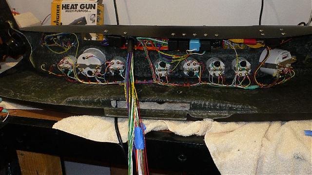

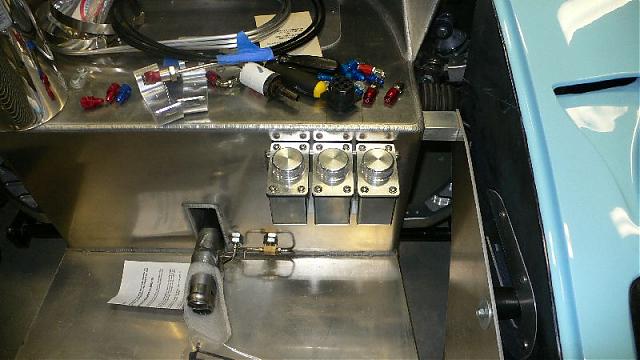

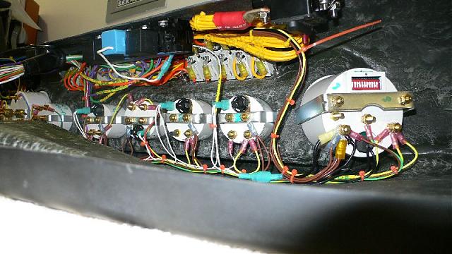

Almost done with dash. All wires cleaned up, and looks a lot better now. Also a shot of the CNC (Brand, not CNC'ed) triple reservoir.

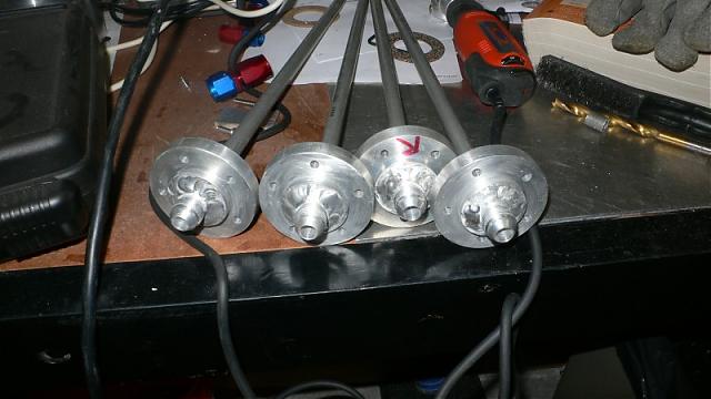

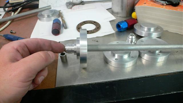

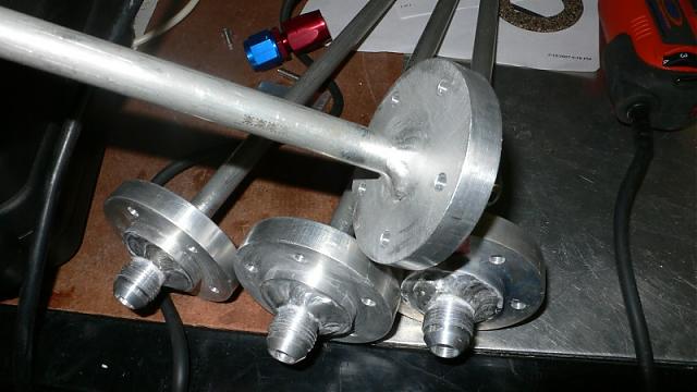

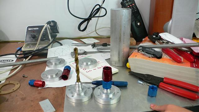

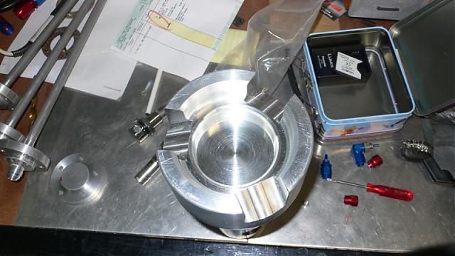

After having a cold the last 3 consecutive weekends I did a little (very little in the big picture...). Made some fuel pickup and returns. Cold Sawed some 2.75" round bar into some nice slices and took them over to my friends machine shop who let me do some lathe work. The hard part is the welding, and far from being good at aluminum, but got it done. Used -8AN males welded to the flanges, then pushed the -8 tubing up and welded. As you can see I'm not ready for my aircraft cert:D
The pics...

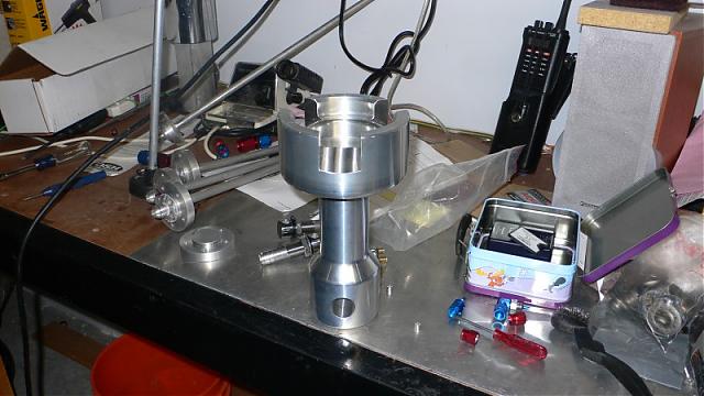

I did pick up a billet Knock-off/on tool from a cobra place in Florida, but it will need to be modified for the big rear wheels. I'll get a pic of that up too might be something useful for us and others.

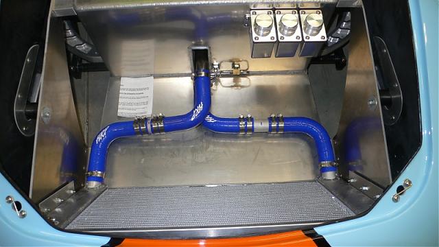

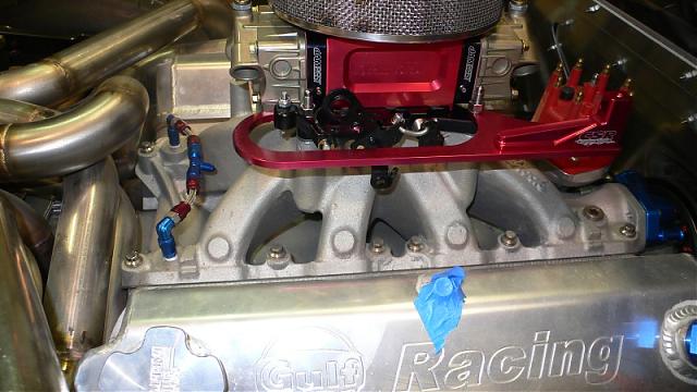

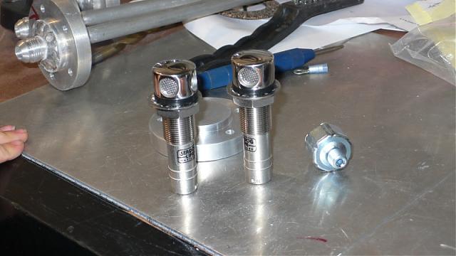

Here are a couple of the front radiator hose setup, and the air bleed returns from the back of the manifold. Just drilled and tapped a 1/8" pipe on each side and used a -3 all around. I had some trouble with the Earl's all aluminum -3 hose fittings after stripping out 2 before I realized that you can't actually tighten them up. Poor design with the amount of threads, aeroquip next time. Last shot is the Knock off tool. It will work for the front's but not the back due to the large offset. I'll likely machine a hex on the back for a huge socket and see if that and the impact will do the job. Last one is the stainless tank vents.

Looking great Sandy!
Please explain your approach for the coolant bleeder. Will it be a manually opperated valve which is periodically checked, or will you be plumbing it to a coolant tank?
Knock off tool looks sweet.
