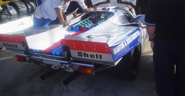

Following on from Dalton --the Ford boss motor (Courtesy SBR) @ 700+hp sounds pretty damn good in this thing and actually suits it IMO the radiator is in the side pod right next the energine, has AC also.
the trans is G50/52 . Definitely Awesome!:thumbsup:
