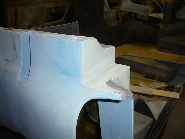

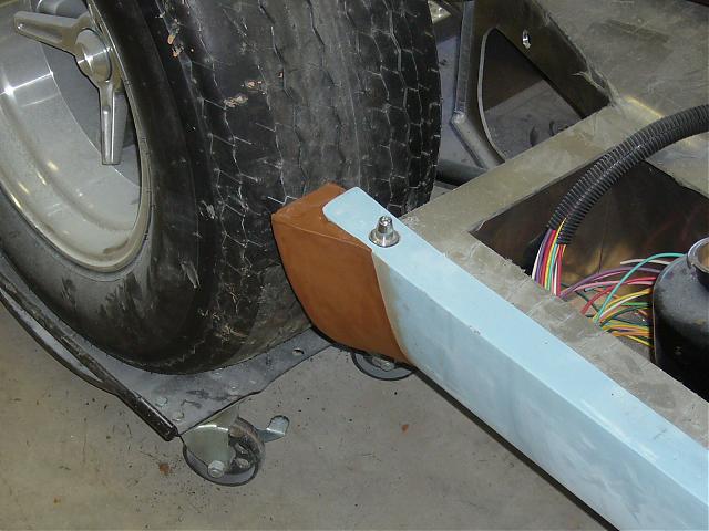

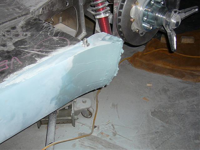

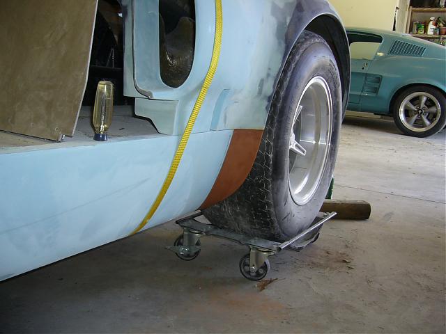

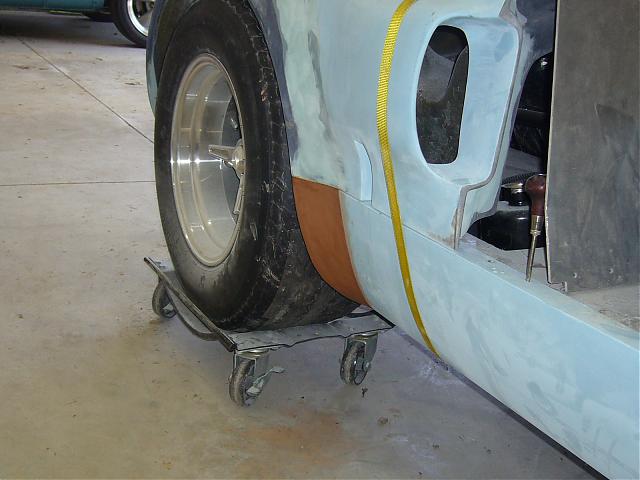

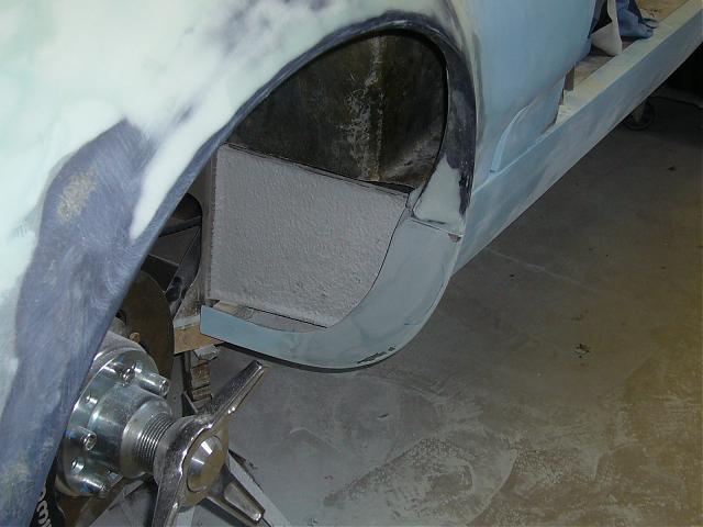

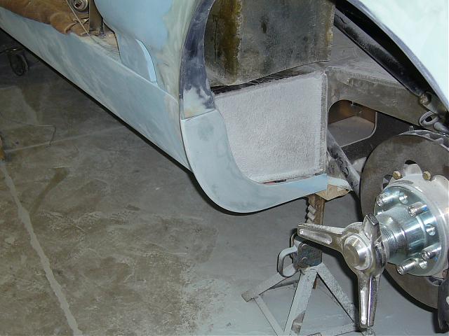

Hey guys.... rear flares are all but done now. Still need to do the rocker flares, will get on those next weekend. Just wanted to share some pics.
Rob

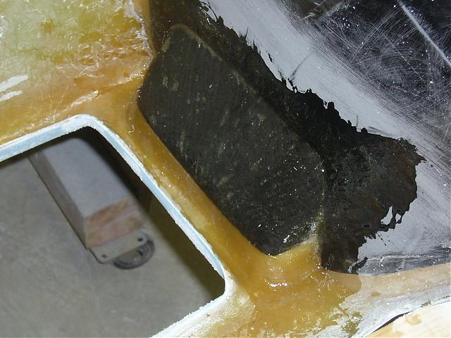

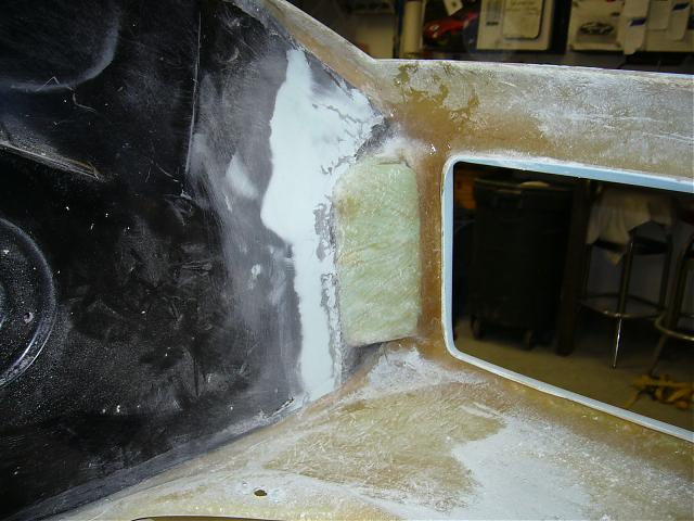

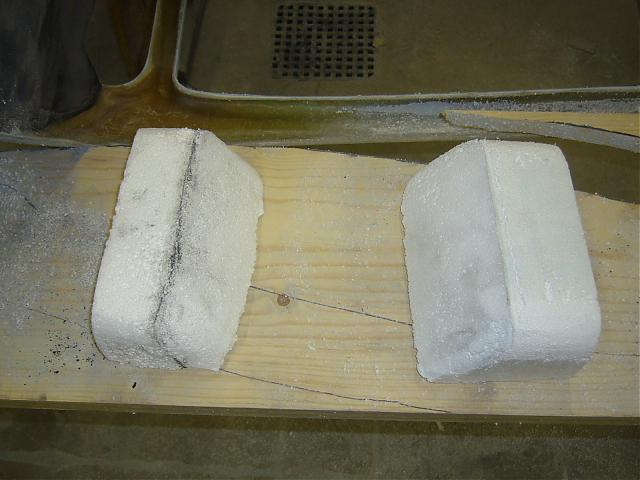

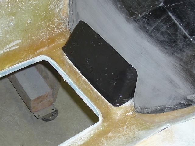

Followed Dean's lead and closed off the brake duct inlets today. Used blocks of styrofoam which I shaped, then covered with plastic garbage bags.
Will break out the foam in the morning.
Rob

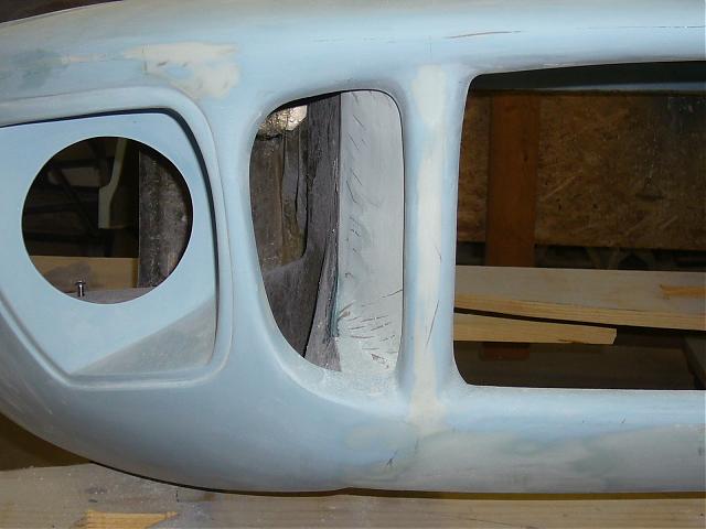

Re: Rob's build

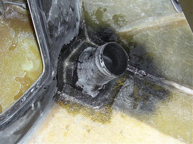

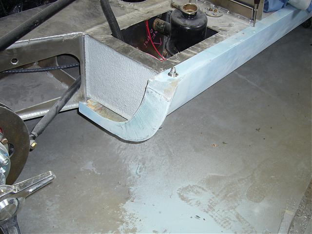

Finished up the brake ducts today, notched the lower front corner of the rear clip for the kill switch, and lots of sanding sanding sanding. I can see the light at the end of the tunnel at this point.:)
Rob

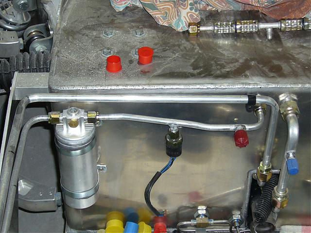

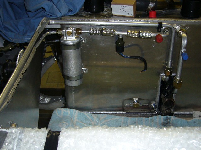

A/C tube aesthetic issue addressed from the 03-06-2007 post....:D
I like the looks of that....much.... better.
Re: Rob's build
Did you do this mod. or is this how they will come from Hot Rod Air? I am wondering if they have taken into account the differences in the center tunnel location on LH or RH drive cars?
Rob
Re: Rob's build
Hey Dean....
This is the plan for how they will come from HRA.
The dimensions will actually be the same, as the LH drive will be a mirror image with some of the bends reversed. The dryer will be on the opp. side, as will the condenser fittings and tubes.
Rob

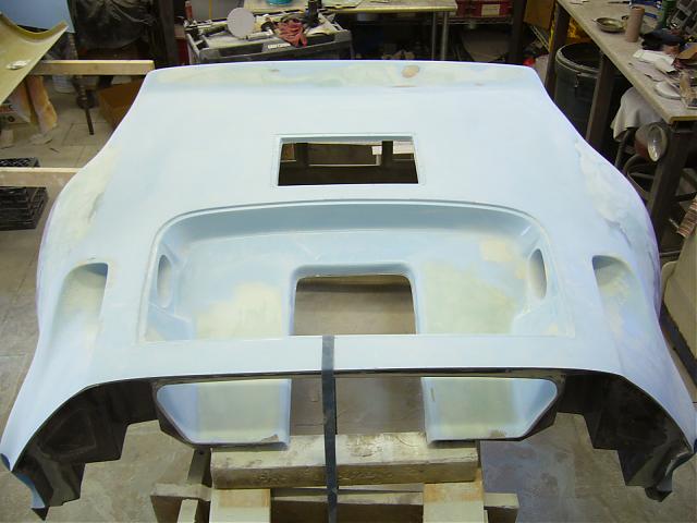

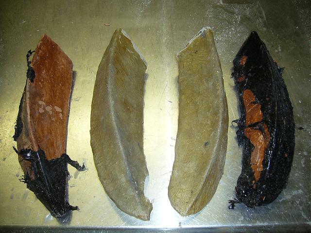

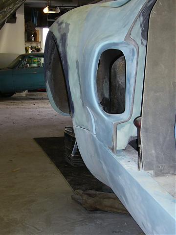

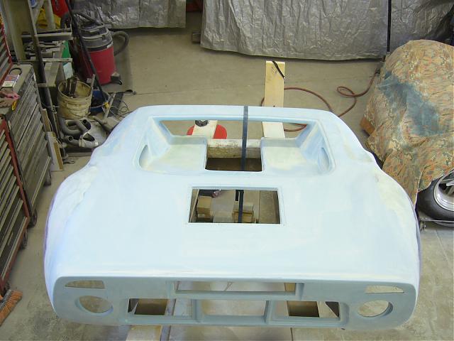

OK....the flares are nearly complete. Made the clay molds last weekend, made glass pieces this weekend. Installed... fill work started. Hopefully can finish the filler work in the evenings after work, so I can spray and sand primer this weekend. (Want to make the most of the bonus day)
Also, glassed in the NACA ducts in the front clip last weekend.
Rob

Re the AC lines, the flare is a single for an O ring seat. It is not one that I am capable of making. Don't know what the flare tool even looks like for it. It came pre flared.
Dalton,
Glad to hear you like it. It was a tough debate....it was that or those ugly hood pin things at the top. I think this will be just as affective for a fraction of the price. ;)
No worries on the fiberglass flares.. :)
On the new AC Line - is that the one now available from RCR? I really did not like the earlier design either..

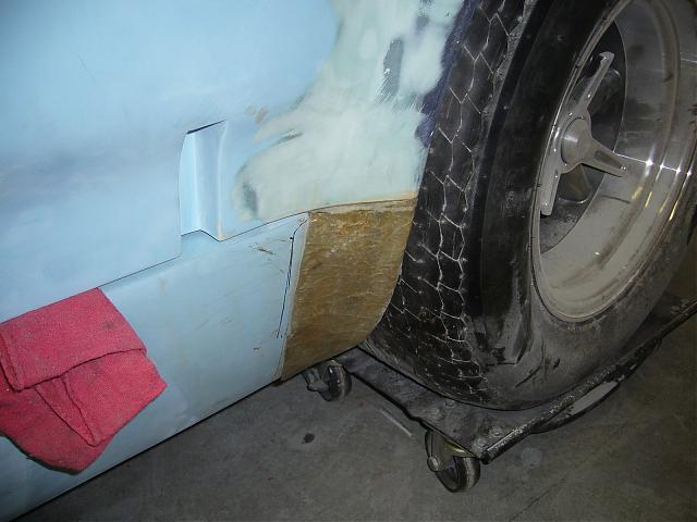

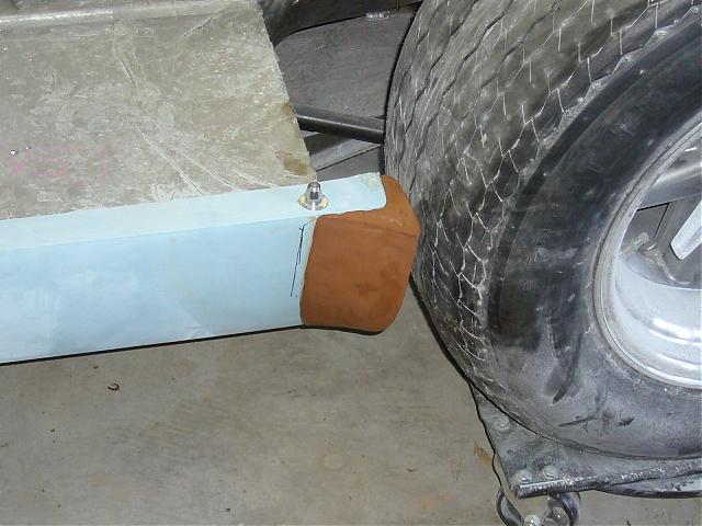

Rob, I could have saved you a lot of work. I make the flare extensions that go on the rocker panels. I'm surprised that they didn't come with the fender flares. When I supply the "Gulf" fender flares, I supply the rocker panel flares too. I'm in the process of casting moulds off some "Gulf" flares with the wheel arch lip that is turned out. These were off an original car with the widest wheels.
I used the ones provided by Fran. They took some trimming if you only wanted a 2 inch total flare. All in, I thought they worked pretty well.
Rob
For clarification purposed..... YES, rocker flares did come with the wheel arch flares from RCR. However, with all the modifications that I made, I thought it would be easier to make new lowers rather than try to change them to meet the modified arches. Key word.... "thought". Not sure now which way would have been quicker. None the less, pleased with the result.
Randy,
Yes, this is what the RCR lines will look like.
