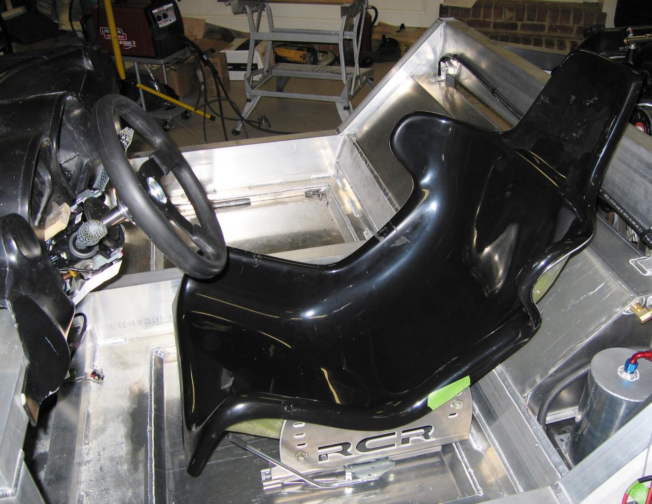

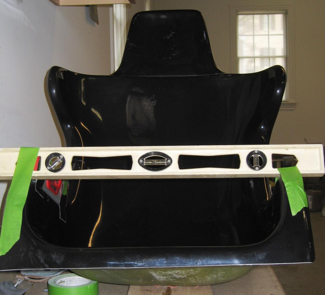

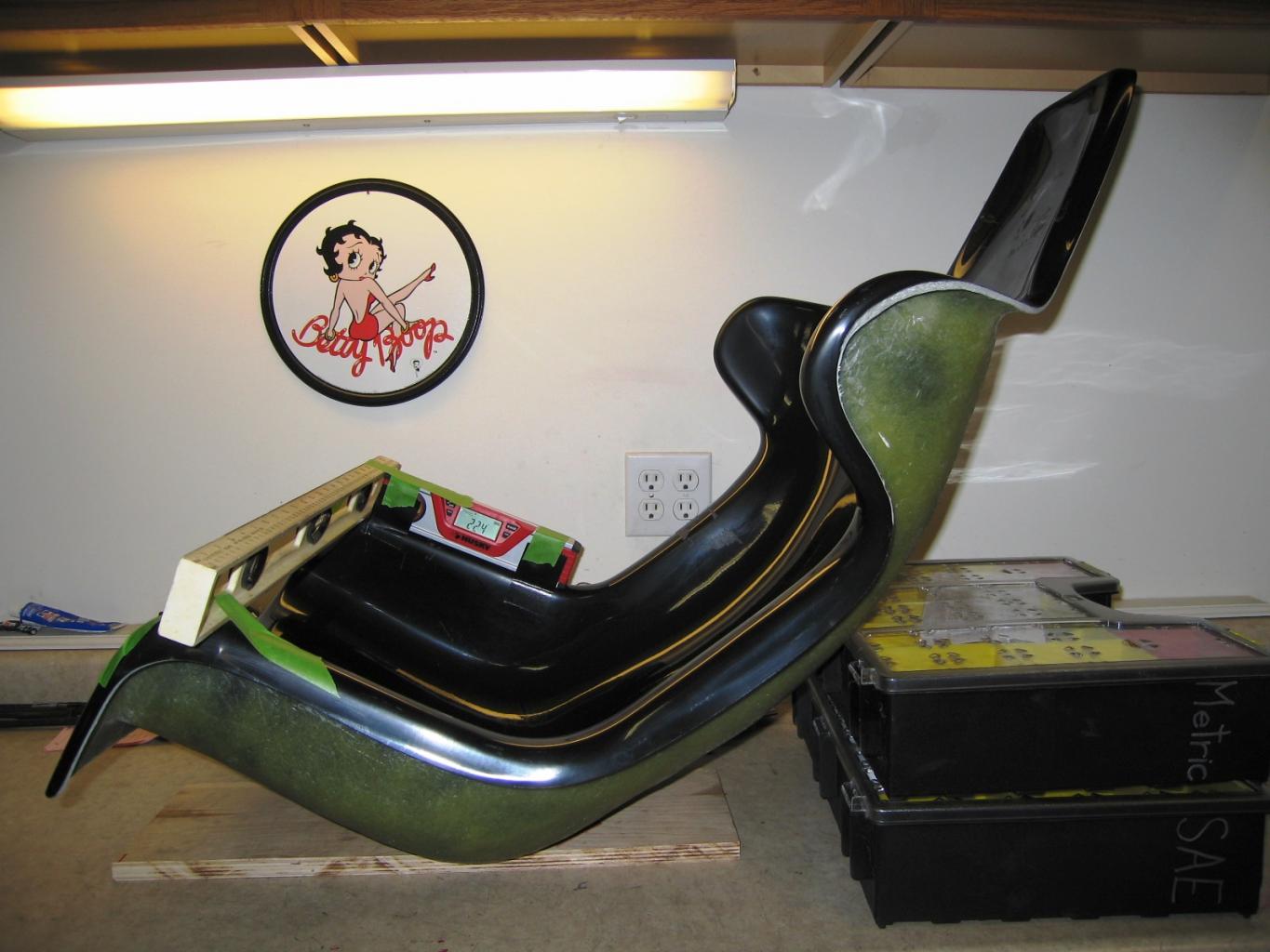

One of the things I've been mocking up is the seat position. I taped a level with a digital degree readout on to the flat thigh area of the seat. Then I placed it in the car and tried to find a good compromise between a comfortable seating angle and headroom. I came out with a 22 degree seating angle.
However, at 22 degrees I’m down low looking thru the steering wheel like a blue haired grandma.
When I look at the seat angle up on my bench, it looks like the 22 degrees is raked back too far.
Is this about the same seat angle that you all are using?

Its really about what works for you Bill. Im layed back about 15-18 degree's in my race car, its comfortable for me, gives me more head room, lowers the weight in the car a little bit
Is your steering wheel at the most comfortable spot for you? Maybe moving it closer will help make it more comfortable for you and change having to look through it?
Ken Roberts
Bill for me it was the seat "back" angle that was important. From memory I think my most comfortable position was close to 45 degrees. It almost matched the angle of the large panel concealing the fuel tank.
Yep also - my seat back angle is almost parallel with the interior gas tank panel, but the bottom seat area is also just slightly elevated at the front edge/lip -- GTM donor seat. I don't think I'd care for the front of seat digging into the bottom of my legs.. for a street car. So many different body types in relationship to seats - this has been a real quest around here.
Ours are much more upright. Very close to having the seat bottom level and only the built in angle of the seat back.
same here ... having it angled like some people have is scary to me ... not for safety, but just driving like that freaks me out, couldn't get used to it, hah. I'm 5'7 and only have about 3 finger widths between the roll cage and my head w/ how I have my seat set.

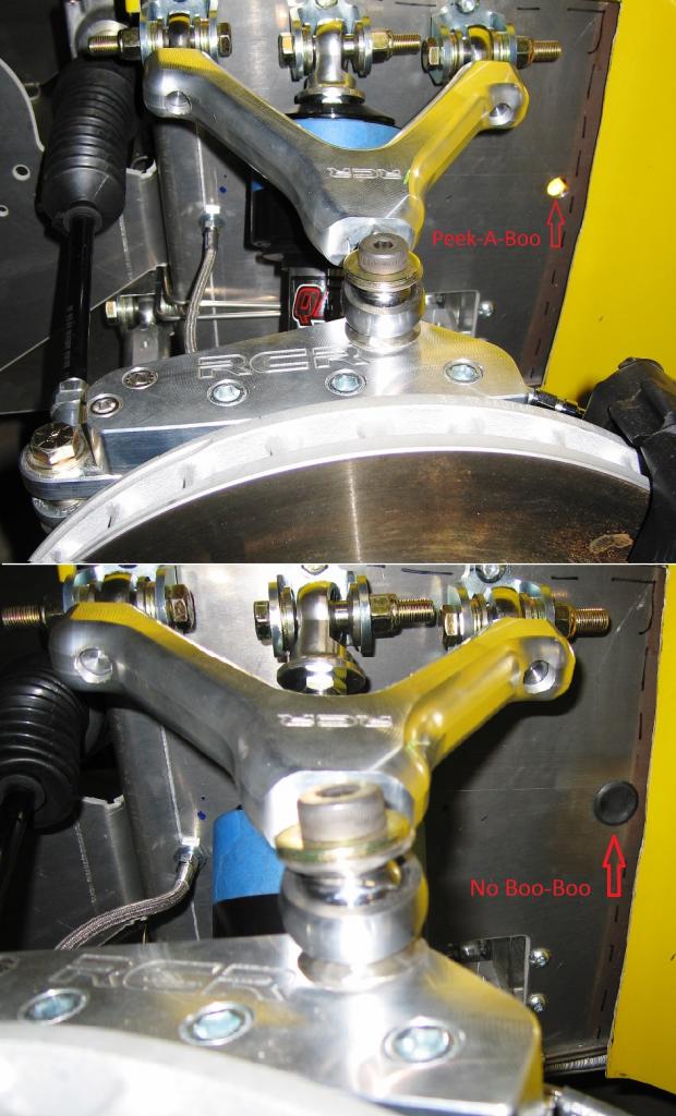

  • I moved my front brake lines forward to give me some additional room in the foot box. That left a gaping hole to deal with. Fortunately, Steel Rubber products HQ is just 30 minutes from me. I went there today and rummaged thru their parts and found a plug to cover the original brake line hole. Steel Rubber Products PN 35-0197-31 works great. You will need to enlarge the hole from .6” to .75” to use the plug. See Pic below.

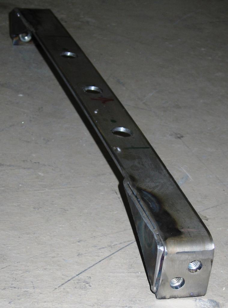

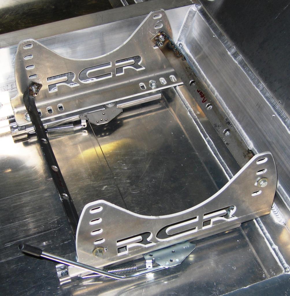

I got my driver seat installed.
I mocked up a couple different approaches and landed on a hammock design. I fabricated front & rear 1/8" steel straps that go under the seat and bolt to the RCR seat brackets.
The under seat braces also have 2 nuts welded on the end about 1/2” apart. The slots in the RCR seat bracket are spaced 1” apart, so the combination allows ½” position adjustments throughout the full range
Once I have the final seating position, I plan to permanently fiberglass them to the underside of the seat. The under seat straps have 3 large holes in the middle to give the fiberglass something to grab on to, so they won’t slip around.
I decided to go with seat sliders after all. That raised the seat brackets about 1” so I drilled a lower set of adjustment slots in the front to compensate.
The end result is quite strong.

The best price I found for seat sliders was at Speedway Motors. Just $25. Since the seat structure is flexible fiberglass (vs steel) make sure you get sliders like these that have a position locking mechanism on both runners.
