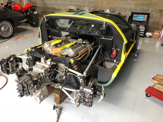

Achingly slow progress, but I've gotten a local expert to help out. Torn down for him to look it over.

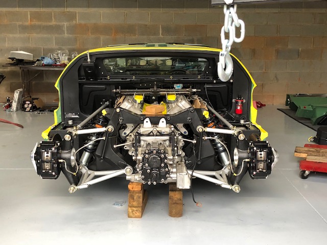

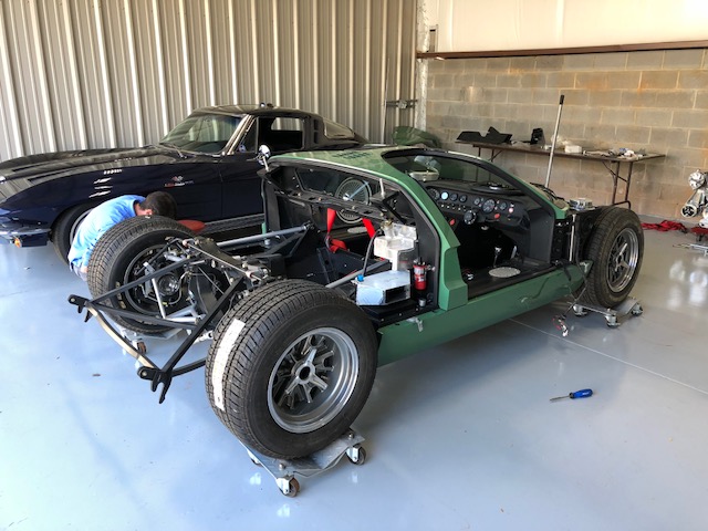

Ron Scarboro

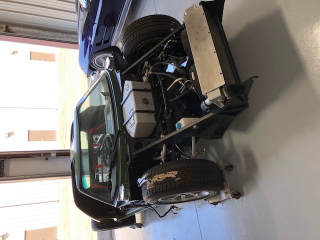

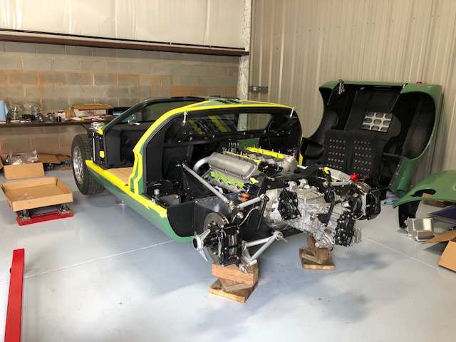

So after coming apart to come together, we're making progress. Big thanks to my installation expert or it would likely be still waiting as a roller.

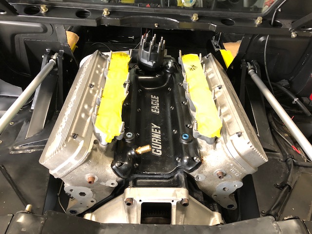

Ron Scarboro

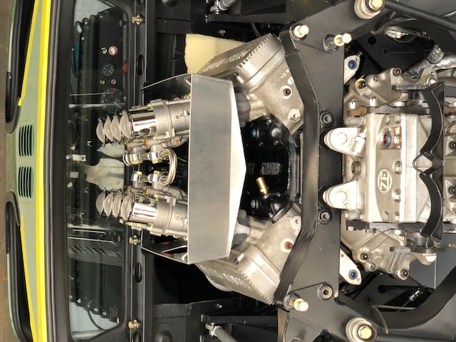

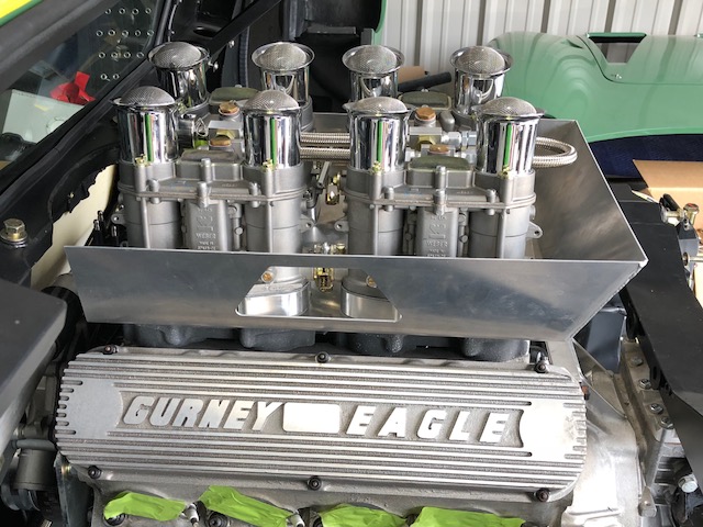

Mocked up the carbs today.
Now that's a proper head and intake! I tried to get Borla to machine my stack inj manifold with a 10 deg angle and they wouldn't do it. Also, the current fuel rail design would present a problem. Love the look and can't wait to hear it!

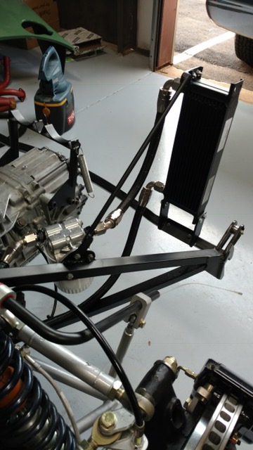

Ron Scarboro

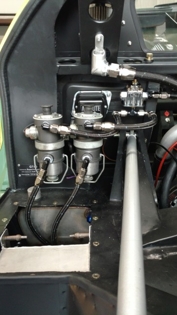

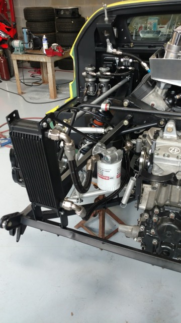

My man man Paul Whitlock is making steady progress. He has done some clever things with the oil breathers and fuel plumbing.
Having an expert builder who’ll entertain my crazy notions and preferences has really enhanced the experience for me.
That looks tremendous. The oil cooler location should be far better than the factory location, I believe you will get better airflow

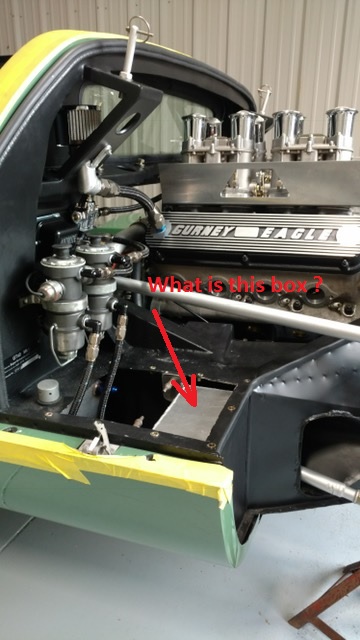

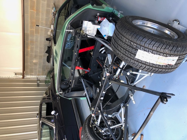

Hi Ron,
Following your post since the beginning I was wondering what is the small aluminium box at the rear of your left fuel tank ? Is it an intermediate small fuel tank (as I have on my GT40) ?
How did you connect your 2 fuel pumps ? One on each fuel tank ? or both on your left fuel tank ?
Thanks, OliveR
Ron Scarboro
OliveR,
Yes, it is a small surge tank. I believe Paul's plan is to have a pump for that tank and each of the Stewart Warners pick up from the surge tank and each pump to the fuel pressure regulator.
