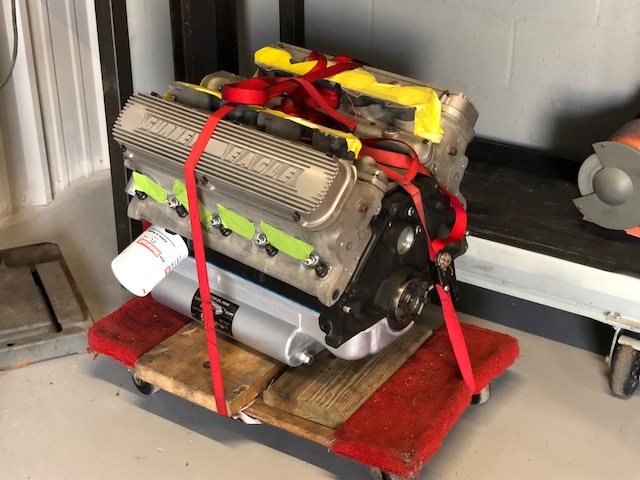

The motor was built using Gurney heads by a former Nascar engine builder local to Raleigh.

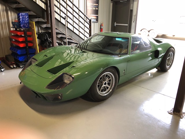

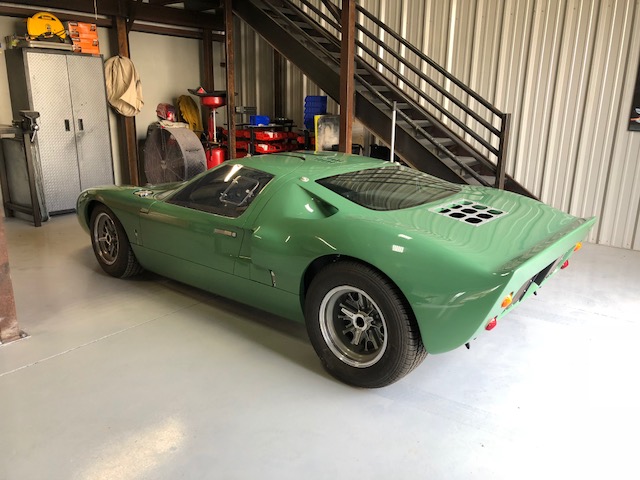

So, FINALLY things are moving. Got the car over to the shop today. Clutch and airbox ordered from Safir, and a big thanks to Rod Brace for the ZF Gearbox that will be coming.
Couple of pics.
