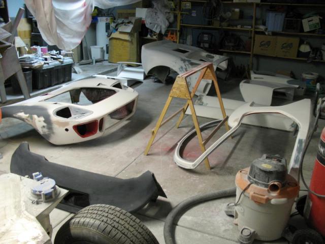

Yes it's true. The temps in Phoenix have dropped a bit recently and I have been able to spend some time back in the garage.

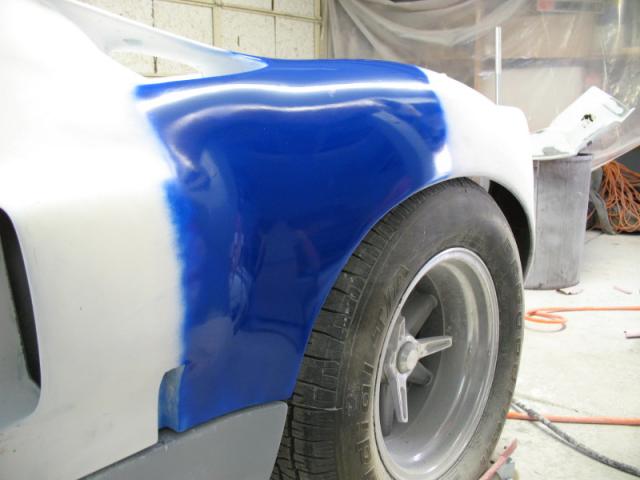

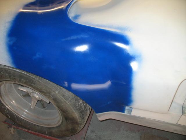

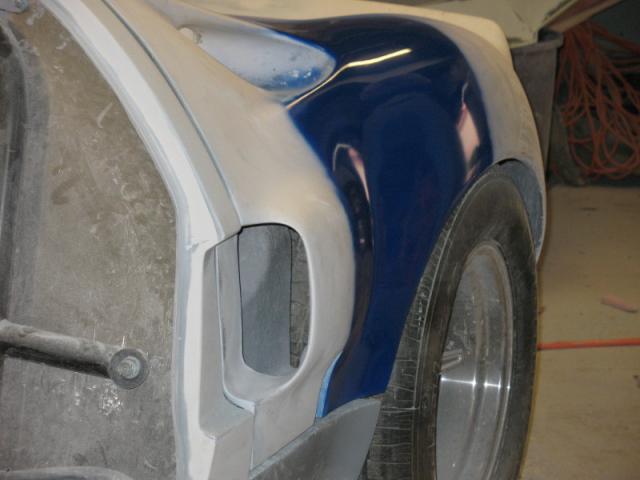

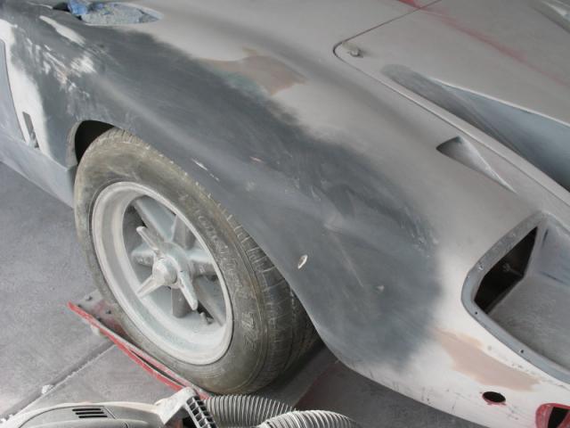

I chatted with Spike and got a few tips for addressing my remaining problem areas (Thanks Spike). These were various small areas of the rear clip behind the scoop and in front of the wheel arches. I needed a different touch to the sanding I was doing and I finally turned the corner on it. I have seen enough 40's though that I wanted to be sure, so I grabbed a rattle can with a shiny dark blue in it and sprayed a bit through this area to check the reflections (I am using as light a primer as possible due to the white color). I was more than pleased with the result!

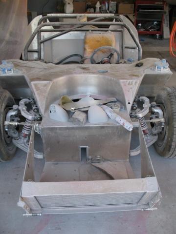

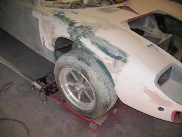

Next up was the front clip. When I hinged it originally, I didn't have it squared properly and as Tom noted in one of the earlier posts, it was subtly higher on one side. It became even more distracting when I put a bar across the grille for a tow eye- it looked like it was slanting across the opening. I straightened this out and got things leveled.
But nothing is ever simple. Upon doing this, I noticed that the right front fender over hung the tire considerably more than the left one. Remarkably, it was by about the same amount which I cut the fender apart and widened it by last year. After spending the time to get the nose level and all the gaps even I wasn't in the mood to just leave one side hanging out that much more than the other. So you guessed it, I went back at it with the saw and took out the mod that I put in. All you guys with RCR's at home who ran to check out your clips with tape measures can rest easy. I've put it back to where I got it.

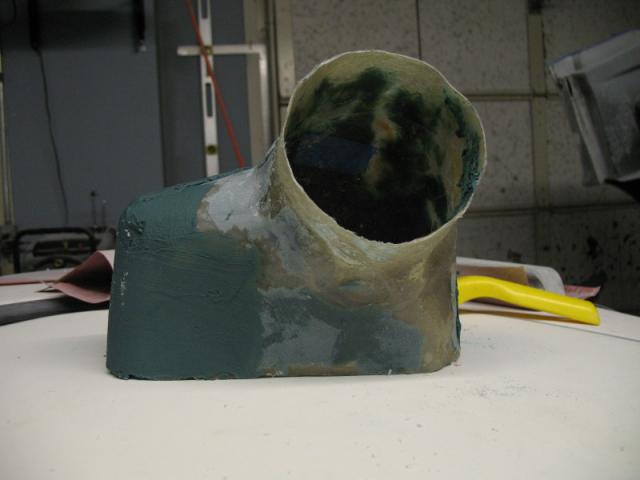

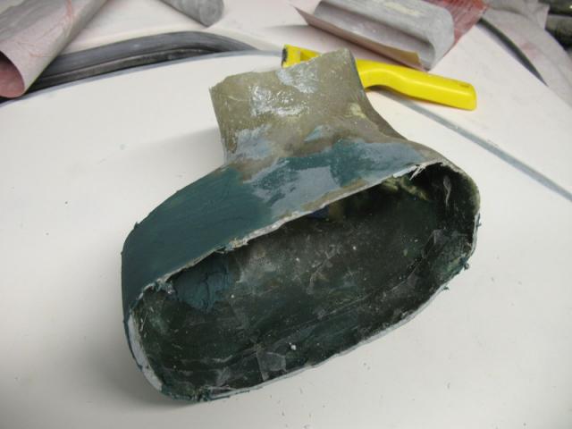

After all this went down, I also needed some positive reinforcement so I started working on some brake ducts for the rear. I know Bill Hough does them but I am interested in my own. I modeled the shape in foam, sealed it with a layer of glass and then pulled a part off it. I know it's not the original configuration but I will connect it to the caliper with a bit of hose later on. I just realized I only have pics of the pattern under construction. Use your imagination and you'll figure out what it will look like...

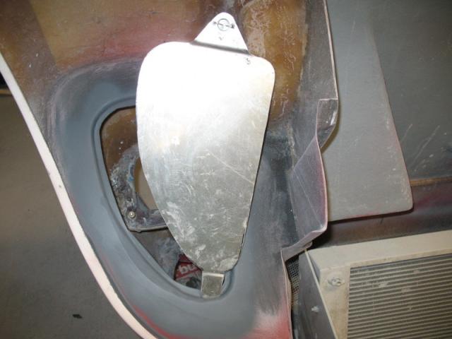

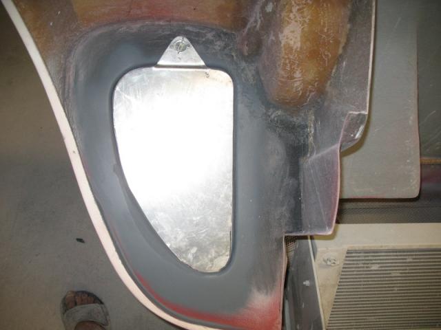

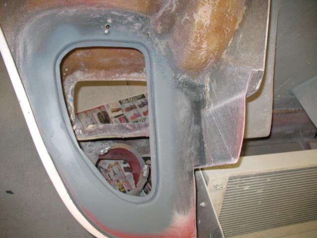

Lastly for now, I made the driver's side cover plate for the headlight compartment. I had some alu laying around, trimmed out the shape, bent it for the tab at the top and then put in a winged Dzus fastner to hold it in. I will put some of the self adhesive foam on it to keep out the water from the backside but want to powder coat it first. I thought it was a pretty good and simple design though. The passenger side will follow in time.
That's about all for now. I "only" have the sill panels left to sand down (already started on one) and prep, then with a little more finish prep I will be ready to spray primer again. As I sand, I am still smelling the solvents being released from under the sealer coat. As big of a pain as this is, I am glad that I didn't spray the white as well. I am glad this final coat will be starting from scratch.

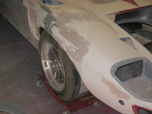

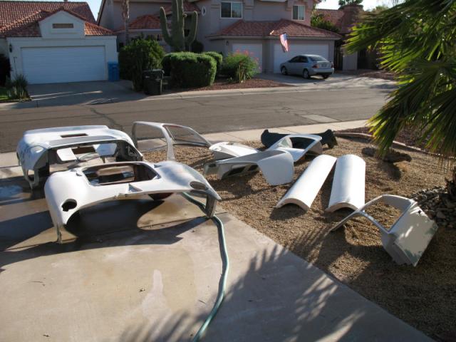

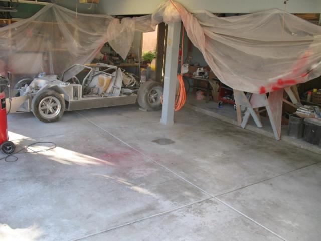

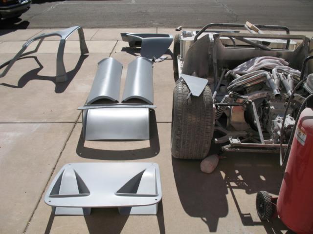

It's been a few good productive days. I didn't manage to get as far as I thought I would by today but the good news is the garage is cleaned out again and I am pretty close to being able to spray primer again. It felt so nice washing all the dust out.
Fingers crossed for primer next week!

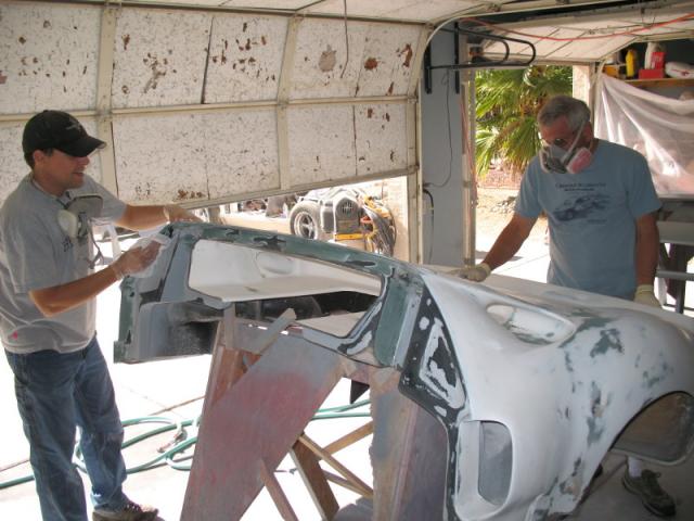

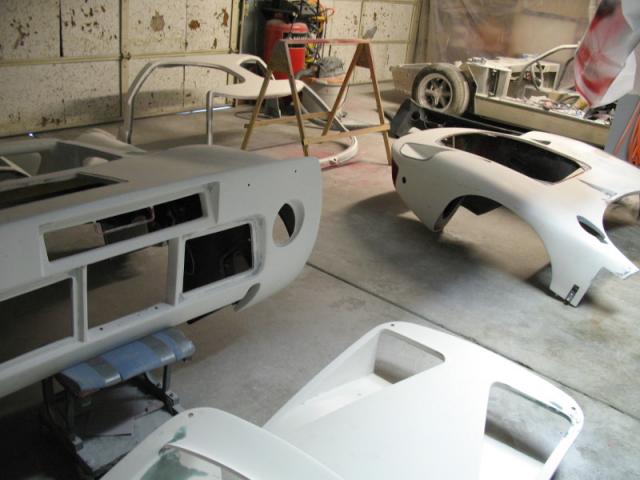

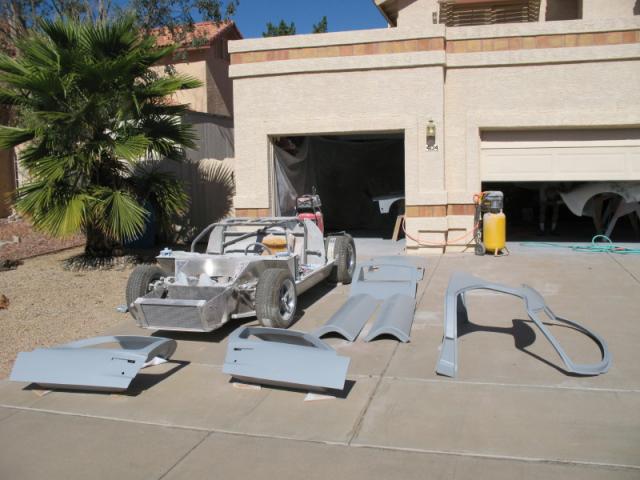

Chris Kouba

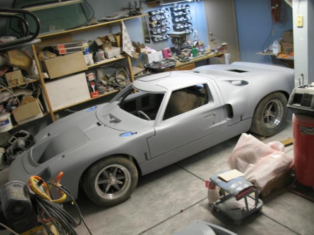

The pics are pretty self explanatory. My dad was in town and I had a friend who's done a bit of painting come over and we got it primed. With it all in one color, I can see I have a little touch up to do on some surfaces but this time it went down smooth and easy. Actually, it did the first time too but this time I was given the correct chems and we used them. I am trusting this will show in the results.
Thanks to Dustin and my dad for their efforts!
