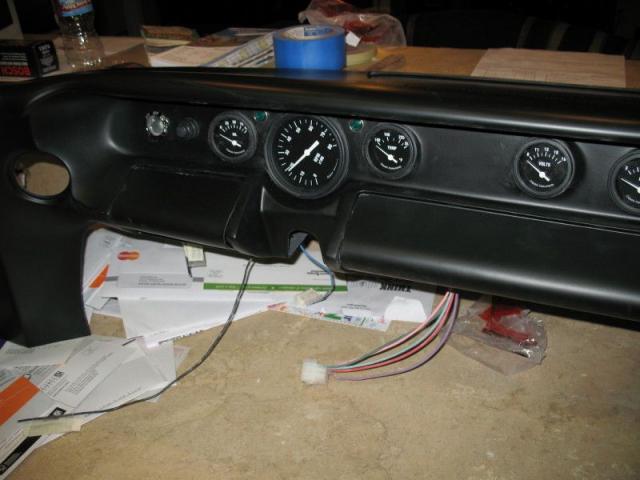

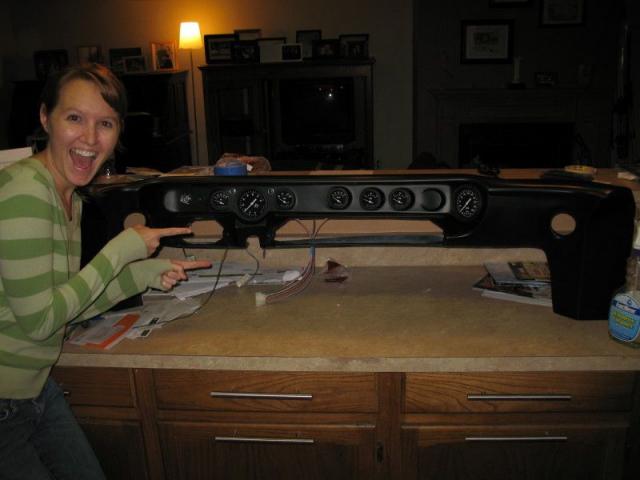

Nice work Chris.... So is that the wife saying "Hey!!!! You have 15 seconds to get these car parts off my kitchen counter!!!!" :)
Chris Kouba

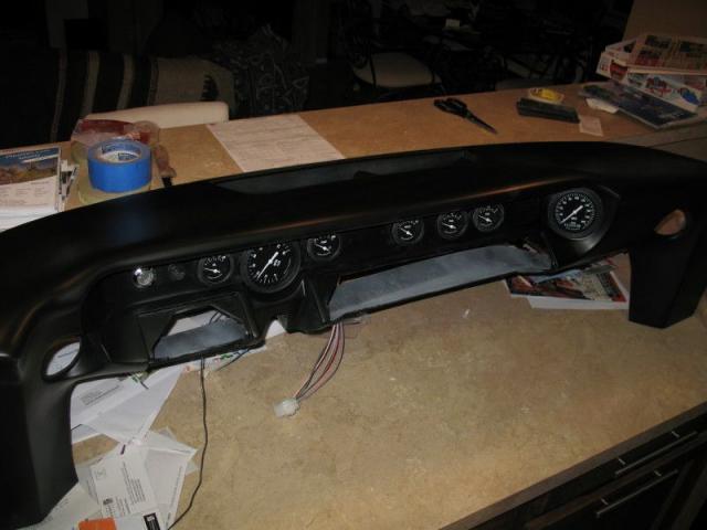

Nope Randy, that's the future wife (Bethany) who is incredibly supportive of this addiction of mine and she's sharing in my excitment of actually having completed something. Ok, it might not be totally complete, but it's painted and gauges are installed. And it looks GOOD!

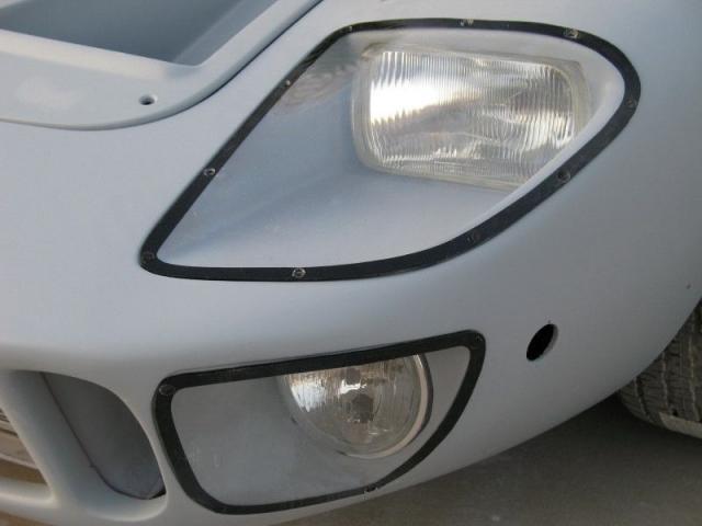

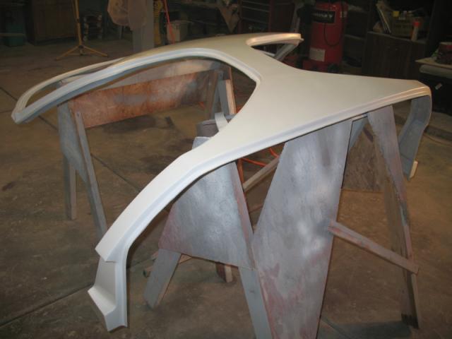

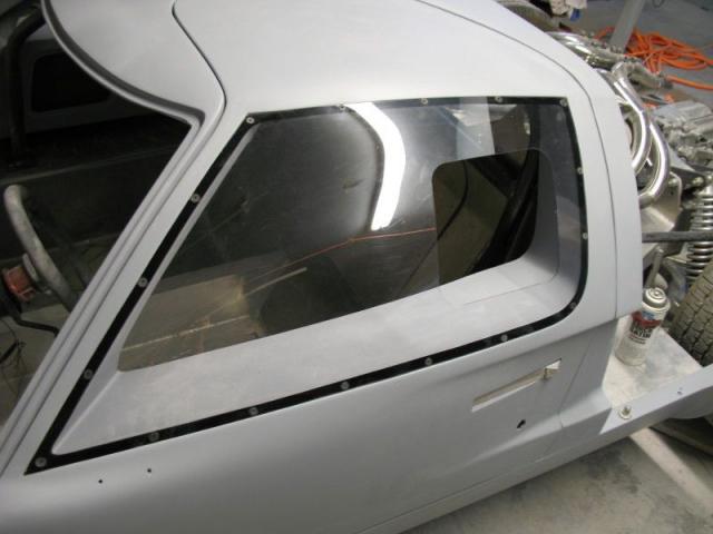

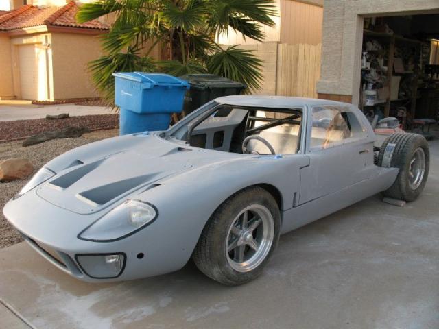

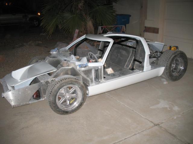

Although the thread's been idle, I've again been sanding my fingerprints off. So far so good and at this point I think it's ready for paint. I'd like to say a quick thanks to Ron McCall and Rob Barusso for chatting last week. I had a few questions being a rookie painter and they got me pointed down the right road (although it meant more work for me). I kept burning through the primer on some of the edges/corners and I wanted to know how not to. Rob had the best answer: don't burn through. In the end I sprayed primer a number of additional times in a number of additional places and did a lot more sanding. At this point though, Dustin and I are slated for a Thursday/Friday spraying so if you'll all keep your fingers crossed.

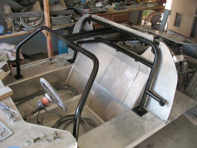

As for other progress, I took the liberty of removing the cage and my homemade rear clip support to give them a coat of primer and satin black. I think they look good enough for now. I do intend to powder coat them in the future.

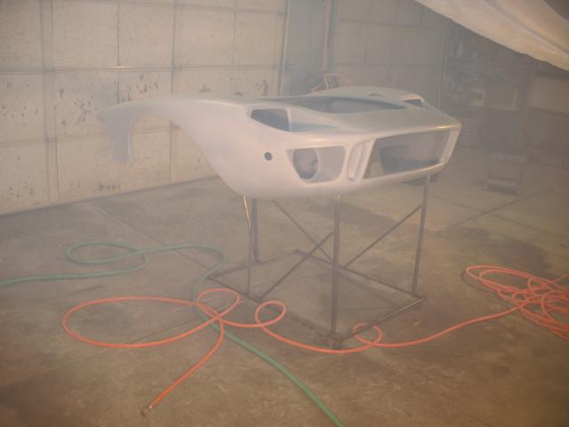

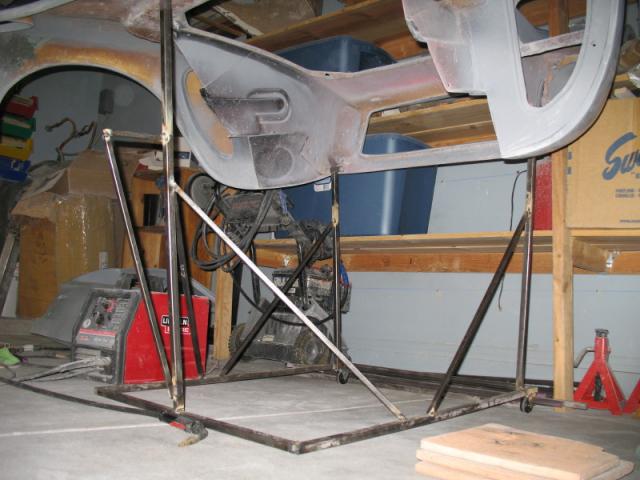

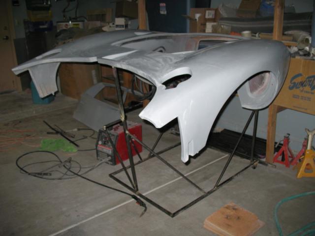

To move the clips around, I have been awkwardly carrying them. I figured out the other day that this would be complicated with fresh paint on them. I needed a way to move them without risk of damage. I spent a few hours today knocking out a two wheeled cart for the front clip. After work tomorrow I will do one for the rear and possibly the doors. It was totally low-tech and low-precision, but it went together in a snap and certainly gets the job done. Coolest part about it is that all the metal was from remnants at one of the local supply places and I made it for less than what the 2x4's would have cost to make it in wood. It probably took me half the time as well. I love working in metal- even my welds looked decent after a year or so of nothing.

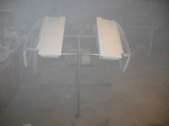

Currently waiting for a tack coat to dry...

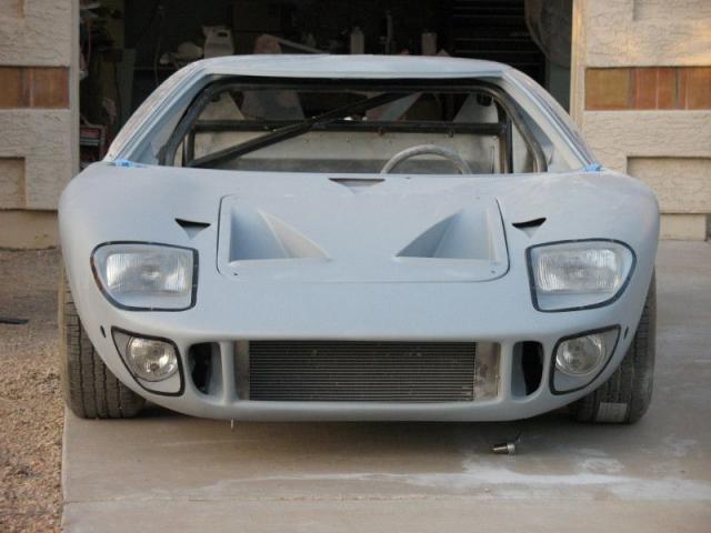

Chris Kouba

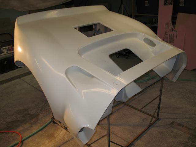

Half way home. Got the white done (eventually) and now need to mask off for the red. Unfortunately, I'm out of weekend. Needs to wait til Weds at this point. I also don't trust myself starting to set a paint mask at 2:30 in the morning...
Man this stuff takes a long time. Dustin had some dad duties come up but another friend, Ben, stopped by for a few hours on Thurs. Other than that, it's been slow, solo progress. I have a new respect for people who do this for a living.
The most important thing- no chemical reactions to peel the paint. Yay!!

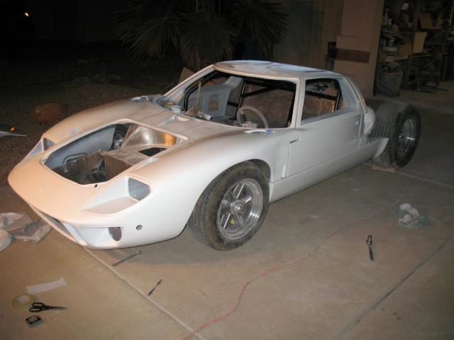

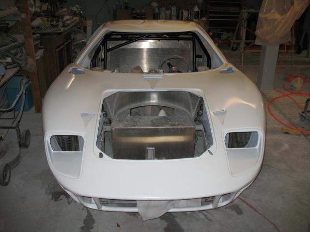

Shiny white and looking good:

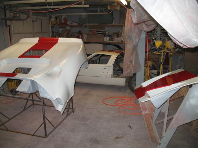

Thought about it Rob and kept after it for now... On with the red.

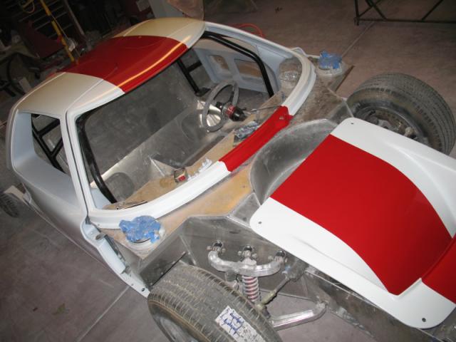

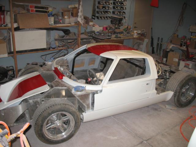

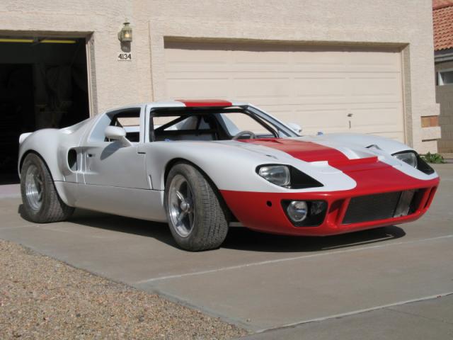

Chris Kouba

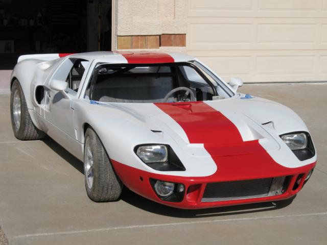

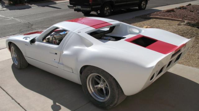

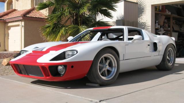

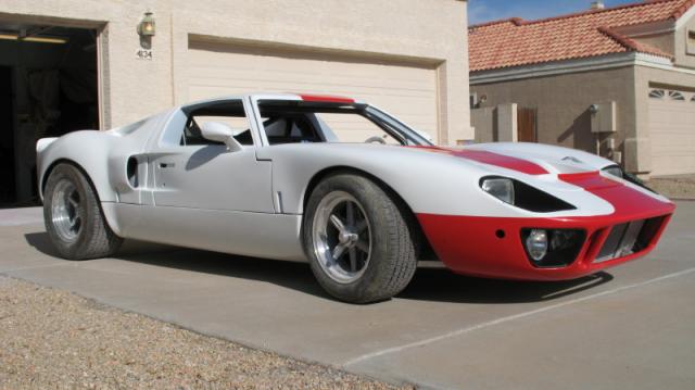

Thanks Allen, I totally agree! But take a look for yourself...

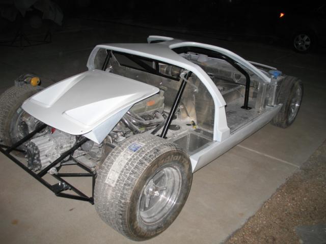

Chris Kouba
Thanks guys. I am thrilled about how it looks and couldn't be happier with the end result. I've had neighbors stopping by and "wow-ing" over it, knowing how much time and effort I've been putting into it. All that time I spent working in the curves with the flares and the project I made out of the nose came out wonderfully- it looks absolutely fantastic. I really couldn't be happier!
If anyone is thinking about painting a car by themselves, heed these words: it is A LOT of work. If you've prepped it correctly, you'll know what "A LOT" of work is. I started working Thurs am and got to where I am at about 11am today (Monday) with only a little time off on Fri evening and working fairly long days/nights (check the timestamps on the photos). I am still amazed that people will do this for a living and actually make money at it. They are clearly better than I am!! Mind you, all of it CAN be done by someone, but it is monumental amounts of effort and energy.
I am ecstatic about getting through this part of the build but it's not exactly "over" yet. I have decided not to clear it yet as I am moving to Portland the first week of January and 1- I will want to spot fix anything which gets scratched and 2- I need to get the house on the market (LOTS of cleaning to do). I know it will mean more sanding once I get to the NW but I am literally out of time and I know it's the right thing to do. I also already have holiday plans as well as a househunting trip to go on. It's going to be a busy month or two.
So at this point, as much of the car will be assembled as possible if only just for ease of transport and storage while waiting for the house here to sell so I can get one up there. It's going to be tough to step away after such an intense bit of progress on it but I can't wait to get back to the NW.
